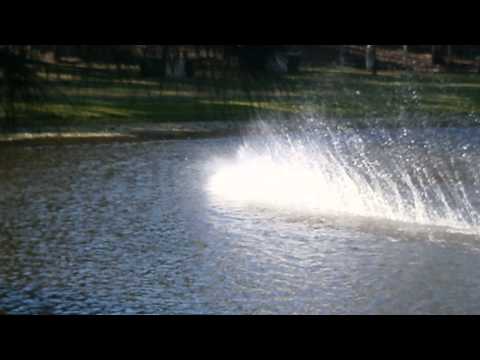

                Jlov.
                I didn't bother with a shim on mine. I just bent the bracket to make it run parallel with the centre line of the hull. Add some silicone sealer to the face of the bracket & in the holes before you bolt the bracket on. that will stop the water problem.
                My hull also started to split along the sponson seams. All I did was carefully wick some medium CA glue along them a couple of times. They're still holding up.
                Tried a different motor in mine the other weekend. A SSS 4074 2200kv. Still spinning the Y547 but comes in cooler than the TFL 4082 2200kv motor did, & is a bit faster I think. No numbers. Just sight & feel only.
                The secret with these motors is that although they are a 4 pole winding motor the rotor is a 6 pole magnet set up. Most other motors on the market are a 4 pole rotor I think. They claim a 20% increase in torque. Seems about right to me.
                Here's a clip with it. A bit erratic, but after I adjusted the strut & turn fin, the subsequent runs were a bit better.
                  • 9479
                  #623
                  Looks great!!
