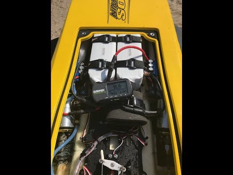

            Record speed from a Zelos twin 95.9mph!
            New top speed from a Modified Zelos twin 95.9mph build by Chris (Dasboata) and owned by Dino Erickson. The video is a bit low quality because of it being compressed via text message. Keagan can you add this one to the modified list? Below is the info.
            Member: Dino Erickson
            MPH: 95.9 mph
            Prop: ABC 1715 by dasboata
            ESC: Dynamite 160 (zelos 48)
            Motors: TP4050 2100kv
            Batteries: 2x 6s Revo 70C

              #156
              Updated! A New King is born! Is Dino Erickson a member here? Forgive my ignorance. So your props by Dasboata on Erickson's boat? 94.9 is impressive! Interesting where those ESC's are.

                        Originally posted by MADRCER
                        Thanks Bp9145...Yes, my bad it's the stock ESC's 120 amp. Keagan can you update? Also, Chris said "the warranty is up" LOL!
                        [ATTACH=CONFIG]153274[/ATTACH]
                        That's even more awesome since the others have more potent ESCs than the Dynamite 120A. . .have to give BIG CREDIT to Chris H. (dasboata) you're the man. . .I told you guys you're going to break the record. . .Dynamite should be proud of their 120A esc and dasboata for finding the right marriage with motor/esc/prop . .get your orders for the ABC 1716 now gents. . .Great Job Dino and Chris. . .

                          Hey Guys Mark and I had a miscommunication Dino fast pass of is 95.9 it was done with my 1715 with 160 amp ESC , he's having a hard time signing up here on OSC he can clue you guys in on the rest he is getting stuck on the question answer page

                            #163
                            OK here are the updated results and this time they should be correct..The updated speeds are 95.9mph with ABC 1715 props. The 1716's weren't used in this run it was the 1715's and the Esc's were Dynamite 160's (out of the Zelos 48). Sorry for the misunderstanding. Keagan please update.
                            MPH: 95.9 mph
                            Prop: ABC 1715 by Dasboata
                            ESC: Dynamite 160 from (Zelos 48)
                            Batteries: 2 x 6s

                              #164
                              Updated, hope Dasboata chimes in when he has time. Great Work! There is no way I will reach those speeds in my lake. 90 in my Zonda was stretching it, another 5-6mph won't happen, at least not without going ashore.

                                #165
                                Thank you but its Dino obsession with speed that drives him he also owns the world fastest Jeep,,, I'm just the builder and repair man LOL,,!!!actually the boat has more in it as you can see it was a short pass there is another area in the lake that we use that will put that boat over 100
