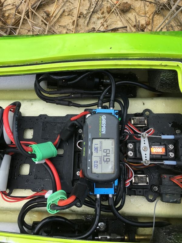

                    So fellas I finally got off my butt and went ran the zelos today with the new motors. I was pretty pleased with the speed I got. Same props, 1814-17-45 abc but I ran it on 4s. Yes, on 4s per motor. I wanted to get a feel for how fast it would be before I tried 6s. Well I expecting about 50-55mph. This motor is only 2000kv so I figured it would be a touch faster than the factory motors since they are higher kv but these tp motors have more power. Well I didn't expect this:
                      #1900
                      Btw, stock escs are still being used. I ran several laps and the escs only saw a max of 108f and the motors saw 101f. Timing is still at 7 degrees.

                        Great job!
                          #1902
                          Thx buddy! I'm stoked it went that fast on 4s with less heat in the escs. On 6s it would be nasty. I'm not chancing it. Maybe 5s but I don't have any 5s packs right now.

                              Nice!!

                                wow! 65mph @ 4S !!! so impressive.... one more confirmation hull is so efficient!
