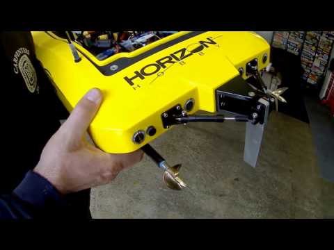

                  The sloppy rudder bushing is a good opportunity for someone to make an upgrade part. Don't mean to be negative however, the strut bushings would wear similarly fast in Geico's and the only reason why I can think it happens is because of the material used is too soft.
                  Is this common to many of these boats?

                    #1944
                    On mine has that play from like the start that I got the boat

                          #1947
                          My bushing does not noticeable play in it.
