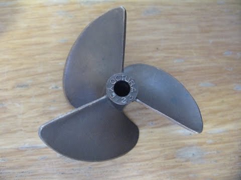

Just evenly and carefully put an edge on it. No science to it. Just do it as straight and evenly as you can. It makes a couple mph difference depending on how dull the rudder is.

Problem is, how do you know how much is enough and what constitutes sharp? For some it slits throats and for others it almost cuts bread!Proboat Voracity-E 36" , Proboat Zelos 36 Twin , Proboat Miss Geico 29" , Traxxas Spartan, Fightercat Daytona, ZondaComment

Sharp....Well the sharper the better to a certain extent. You get it too thin and the edge will fold over easy or dull easy from running it. Just sharpen it to where you could cut yourself if you were to run your finger over it with a little pressure.
The detounging. Do a little at a time. Say 1/16 or so. Try it and see how it does. Ask yourself if you need to be able to jump the boat out the water? If not then a bit of the toungue can be mostly removed. I'll take some pics for examples shortly.32" carbon rivercat single 4s 102mph, 27” mini Rivercat 92mph, kbb34 91mph, jessej micro cat(too fast) wasComment
The detounging. Do a little at a time. Say 1/16 or so. Try it and see how it does. Ask yourself if you need to be able to jump the boat out the water? If not then a bit of the toungue can be mostly removed. I'll take some pics for examples shortly.Proboat Voracity-E 36" , Proboat Zelos 36 Twin , Proboat Miss Geico 29" , Traxxas Spartan, Fightercat Daytona, ZondaComment
