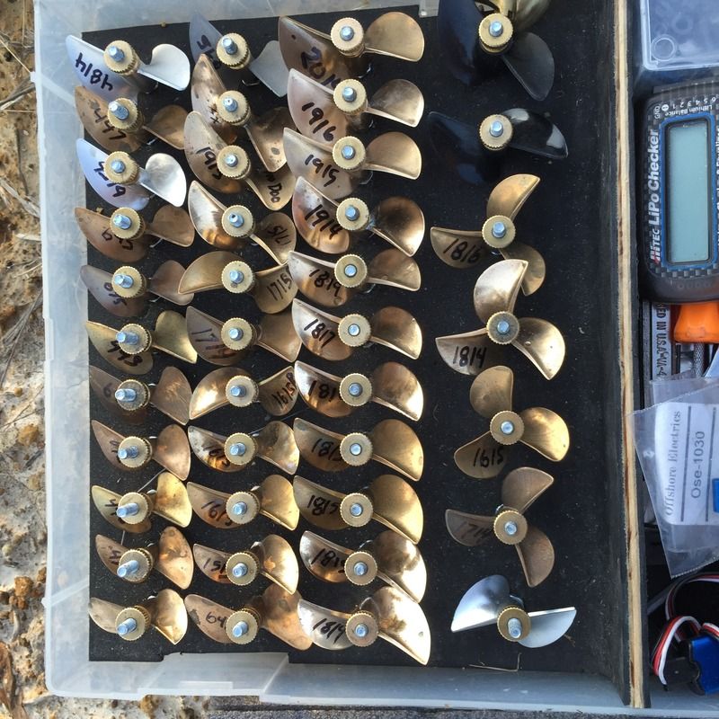

              #456
              Ok. Here's some of my props. The ones all the way to the left have tongues on them. The ones on the bottom left are full tongue on them. Compare the others with less tongue and it'll give you an idea.
              • Keagan-Z06
                • Mar 2016
                • 970
                #457
                Good Lord! That's a lot of props. I did some sharpening today but still a bit hesitant on the detoung. Scared to mess up these props.
