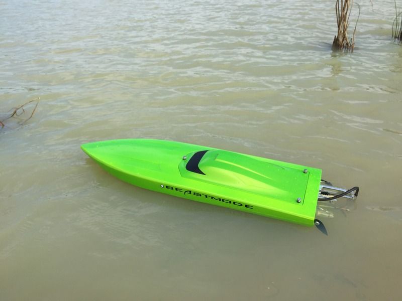

                              #314
                              Originally posted by Erroneous
                              DX4s showed up today. Off with the head of the ol Airtronics. Hopefully get rid of random hickups and gain some range. Hitech digital high torque servo on the way as well. �� Full beastmode.
                              Did someone say beastmode? Lol

                                #315
                                that is a beautiful boat kfx!!
