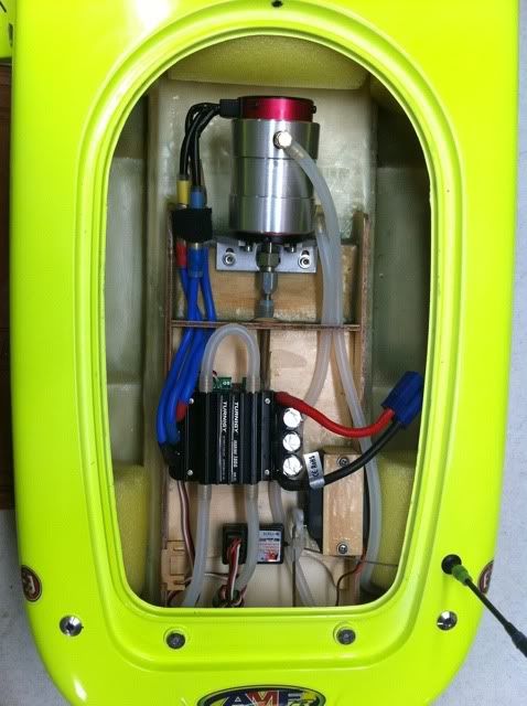

The boats been fiberglass reinforced all down the seams and has an extra layer of glass and resin in the mid to back area for added strength. Sponson tips have great stuff foam in them. I'll be adding yellow pool noodle for flotation as well. after i see where the battery packs need to be fore sure in testing I will then put the trays back inside the boat but trim them down a little to get the batteries to sit lower in the hull. I may add a 2nd water pick up, But not sure till I run and see how the single rudder one works with the t-180 & 4074 1800Kv being run between 4 & 6S.Land, Sea & Air, A true RC Addict.Comment
quick note: when using "y" connector and going from 2 lines to 1 what you make is a bottleneck. think of a huge crowd of people trying to get into walmart for after thanksgiving sale. to many people trying to squeeze thru… same goes for what youre doing. jmo =)Comment
Thanks. But I don't have a Y connector in this. Right now it's single in single out. I have another pickup I may install if I feel it needs it. Then I'll be using that 2nd outlet you see in the back (one on each side)Land, Sea & Air, A true RC Addict.Comment

Here is the 2nd pickup.
I also found if I use a little piece of cooling line over the end of my stuffing tube it keeps the grease from working it's way out and slinging around. Also helps hold the teflon liner in place a bit.
