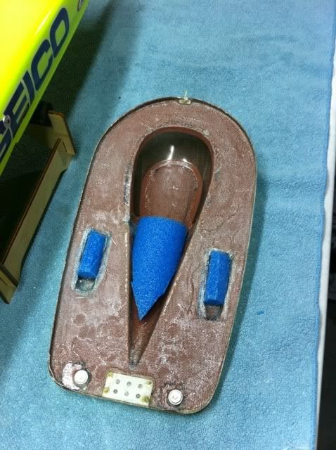

        Originally posted by JPriami
        Got my in hull pickups in tonight. I used 2 of the duals for this. I don't like how the singles don't move much water so I figure each dual Y'ed into one line each for 2 lines, will get better flow.
        I also took the stock cooling line hole and put a grommet in there with a aluminum plug. So now you pop the plug out and if there is any water in the boat you can drain it a little easier.
        awesome idea bro, great way to get the last bit of water out

                    Think I'm done at last. Other than dialing it in and running. Rainy and windy today so no dice.

                            Yeah it's a sardine can lol. I'm going to wait on shorting wires. I have another motor to try if this one dosent work out.
                            Made a grease catch out of a medicine bottle lol. I got tired of cleaning then grease ring in my other boats so I figured this might work
