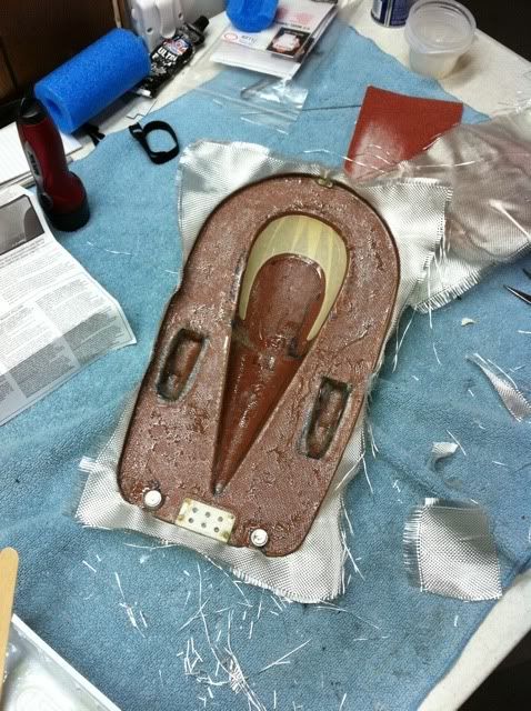

I was going to add another water pickup off the side of the rudder bracket. But I am not liking how the pickup tube looks like it will interfere with water flow and the prop. I didnt like it in front of the prop or behind it.
So now more work ahead of me. Im going to add in hull water pick ups to each side of the rear sponsons.
Its going to be a long night

Got my in hull pickups in tonight. I used 2 of the duals for this. I don't like how the singles don't move much water so I figure each dual Y'ed into one line each for 2 lines, will get better flow.
I also took the stock cooling line hole and put a grommet in there with a aluminum plug. So now you pop the plug out and if there is any water in the boat you can drain it a little easier.
