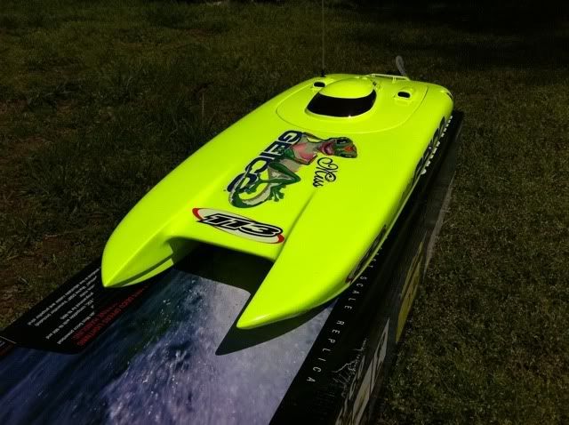

    Got my brand spanking new miss geico today. Damn this thing is sweet looking!
    Took the stock motor and esc out soon as i got off work. Didn't even power that up. It won't do what I will need it to do.
    Let's stuff off huge motor number 1 in there and see if the beast fits because it's just a couple mm bigger than motor number 2 I might be running.
    Well I think i can use the stock motor mount. I will add a support brace to help hold the back of the motor since it's so big.
    I will need one of those great epoxy hatches because the Tupperware lid won't fit now. Kind of figured that.
    Need to do a little modification to the rudder bracket too.
    I've got a list of things I plan on doing for this little rocket ship. it's going to be lots of fun.
