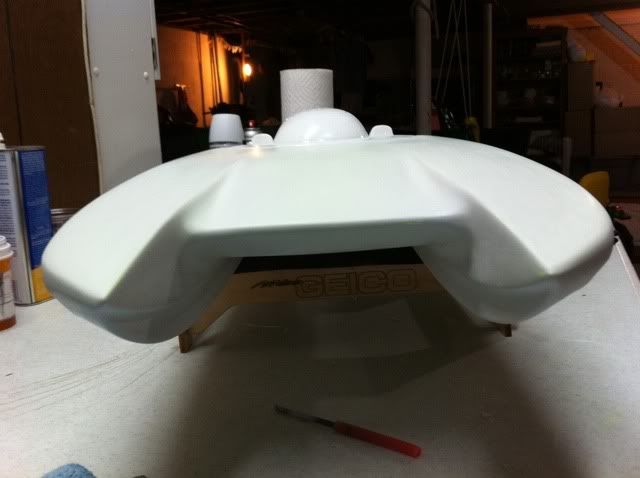

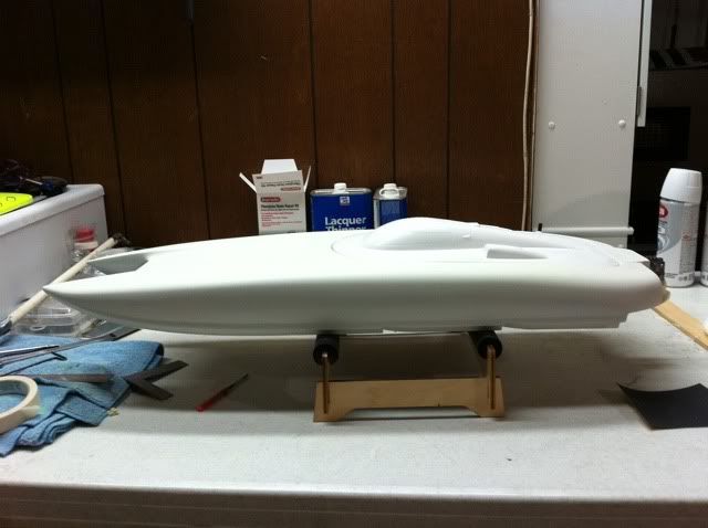

                Got some time to work on it again finally. I rejoined the hull where it split from front to back. Laid up an extra layer of fiberglass inside to add more strength. Fixed the busted out gelcoat on the outside the hull & cracks. Now it been primed and ready to paint.
                Going to paint it all bright white. Then leave the bottom white and spray the top fluorescent neon yellow. Put my decals on and clear the whole thing.

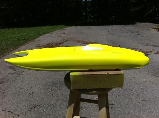

                      Got the white sprayed yesterday, then some fluorescent yellow on top deck sprayed today.

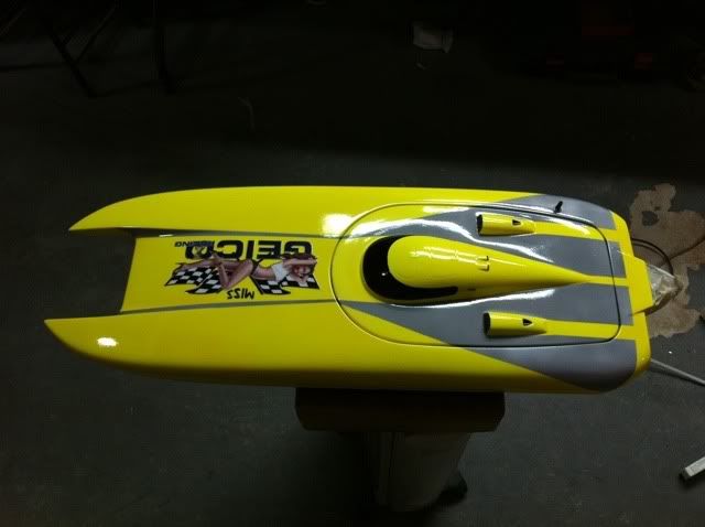

                            Got my miss geico decals on order. Hope to get them soon.

                              After all this work. The stupid clear coat is making parts of the canopy slightly milky and lighter! Oh the disapointment! Still look ok tho.
