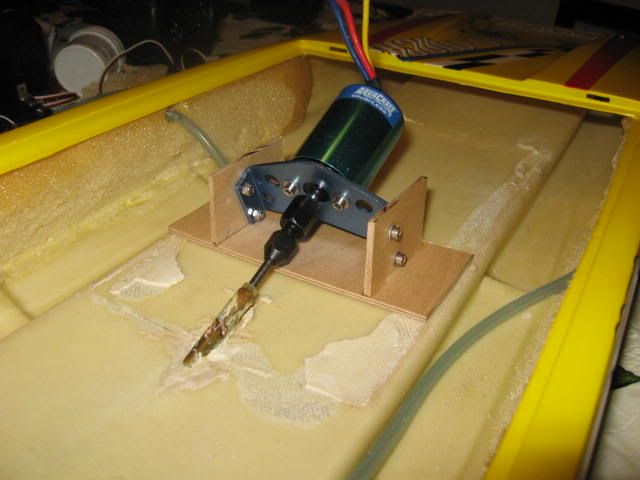

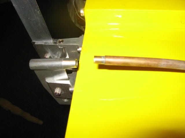

    Quick question and a pic of the mount I made.
    On the hardware, does anything go on the tube or does it just slide in and thats it. I have to reset the tube.

      Nothing fancy but she is basically roughed in, I got a few little things to iron out but for the most part she is done. She only weighs 3 lbs 6 oz. surprizingly light.

        looks good, neat and clean. what did you use to get all that crappy bondo off ? the one guy says West System 2 part. dont even know where to get that

          I chipped as much as I could, then a hand held dremel with a fine grinding bit and very carefully took it off. I took more off after the pictures. Maybe I can try it out today or tomarrow.

            Bathtub test. Auto bailers leak. filled them with silicone. Could not get them out without looking like it may bust the corner of the hull.

              After I got the box and mount out I used a Black & Decker hand held sander with some coase sand paper!
