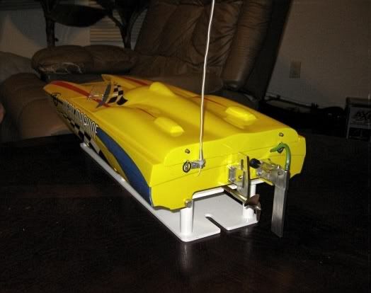

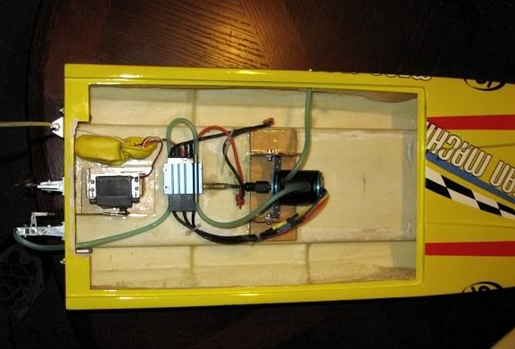

    Well she is done. I moved the ESC back.
    Here is a few vid running two 8.4v NiMh EP4500 packs, the SV power plant, a FM Tactic radio(no extra BEC), and a X642. I like it...

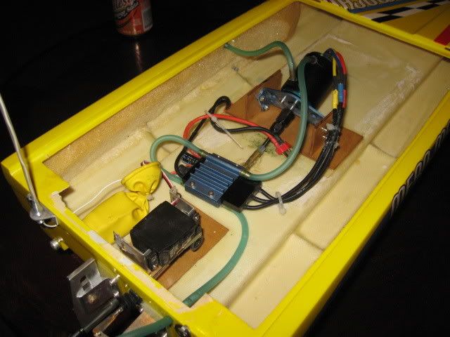

    Here she is, same set up except two 5350 7.4 PolyRC Lipo's Very agile / quick I like it this way to....

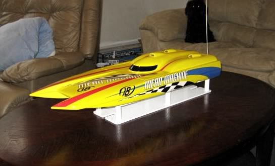

                        Changed a few things, she really runs very nice now. I am 100% satisfied. She lives right there on the coffee table.
                        Well she is done. I moved the the ESC. I am happy with it AS IS. Batteries sit right on the side and can be mover up or back but back is where I run them.
                        Here is a few vids running two 8.4v NiMh EP4500 packs, or Lipo's with the SV power plant, a FM Tactic radio(no extra BEC), and a X642. I like it...
