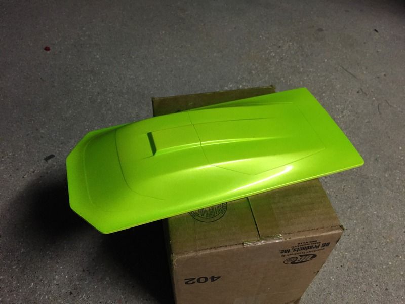

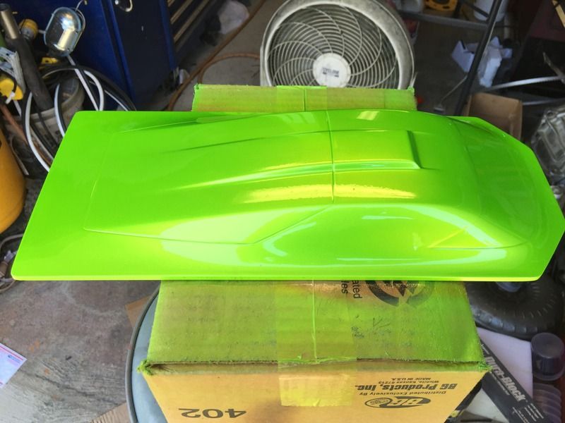

                I'll admit. I'm not pro painter but I decided to paint this thing the color I've always wanted the other one. I could not bring myself to take the other one apart to paint it because I was afraid id mess with the out of this world tuning that boat had. So yes, I sold it to build another one and paint it my favorite color, pearl lime green. You can't find this color in any affordable way except water base. It's a pita to work with because it will run easily if you mix just a tad too much water. The good part is if you mess up you can wipe it off with a wet rag when it's still wet. Which I did have to do because I forgot you have to do light layers and I got excited and put it on mega thick because I wanted to see what it looked like. Lesson learned lol. Here's after two light coats.
                And btw, I'll shoot limco high solids clear coat on it after it dries for a few days. I painted a couple things with this and it turned out nice. Here's the paint

                  I'm getting excited!

                    Awesome Paint color choice. Looking Sweet Man

                      Looks good bud!

                        A good bold color Travis. I like a highly visible boat. I am dying to paint something I my old outrigger colors. Neon! Pink blue yellow and green.

                          I can't wait till it's finished. I'm letting it dry for the night. I think I may need to put one or two more light costs. Then I'll clear it this weekend. Let the clear cure for a few days then finish it up. I'm gonna have my wife cut some decals out for it. Not sure what just yet. I have some black carbon fiber vinyl. I'm open to ideas.

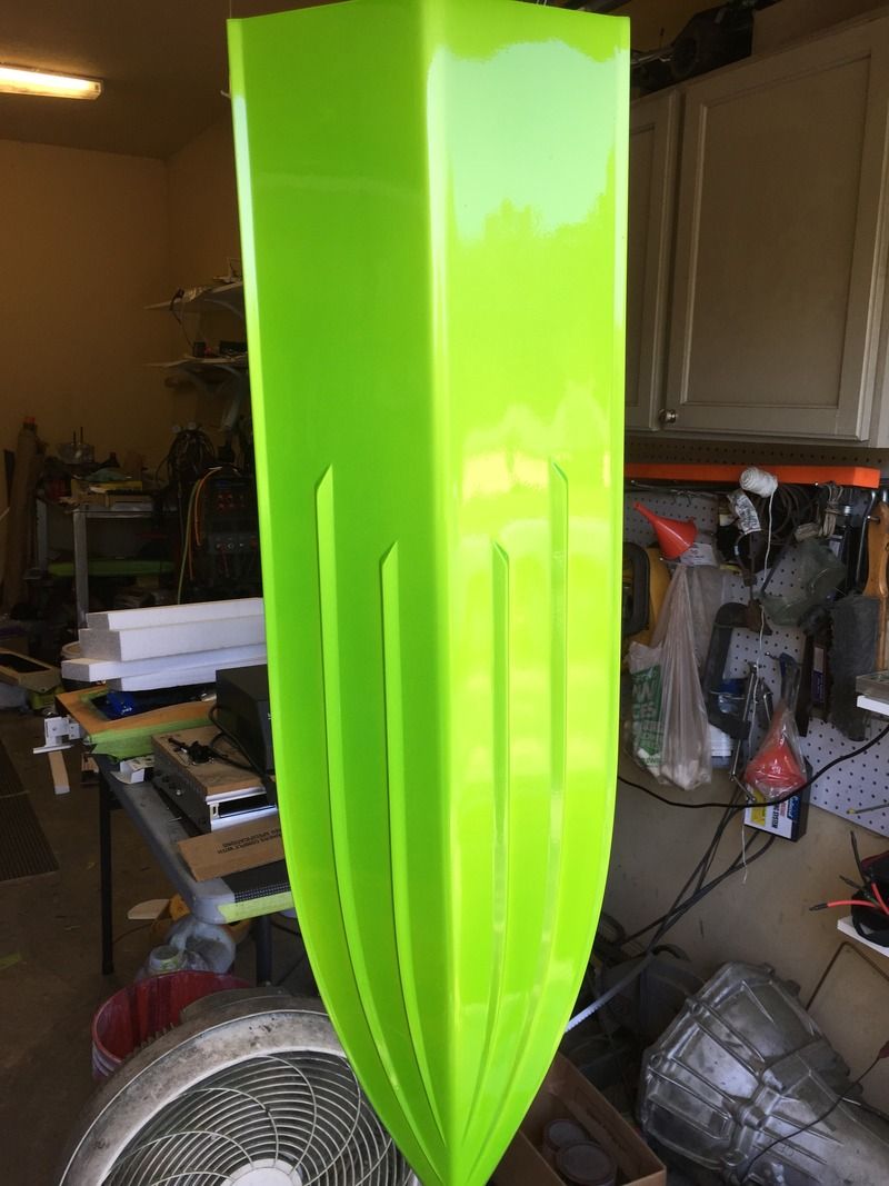

                                Put three coats of clear on it. Looks beautiful! I love this color. Wait till its on the water and in the sun. It really pops. I did end up with a small run on the bottom. I can block sand it out though. Straight out the gun it looks great. When I wet sand and buff it I imagine it's going to look killer.
