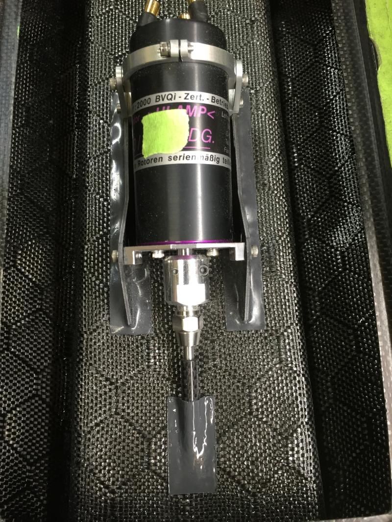

      Travis, just joining in here. Insane motor choice, just crazy. I like it! I think sponson water pickups would be best, eliminate the outside tubing will really clean it up. As far as the other styles of pickups, some look better than others, the word "drag" really seems to get overused. With all the power you have I doubt any style of pickup would noticeably affect speed or handling. I like the stainless steel rudder idea. I have a good selection of 440c stainless and some of the more exotic types I use for knife making. My heat treatment furnace finally gave up and I have yet to replace it so heat treating one for you is out. I could send you some 440c in 3/32" and 1/8" (possibly 1/16" to)if you want to really make an ultra rigid rudder. You'd have to find someone local for heat treating. 440c stainless is pretty straightforward to heat treatment and shouldn't cost more than $10-$15. A good source state side for all your stainless needs is admiral steel. I have a couple blades I already made up somewhere around here. Rigid is putting it lightly! Of course a quality stainless knife blade can be used. Cheap knives just don't compare though. Pm me if you'd like some. I think you'd see some gains from the effort. You should use black epoxy pigment in your jb weld or west systems stuff. Getting everything black will really make things look cleaner inside. I use 2-3 drops for 3 ounces of epoxy, it goes a long way. You could always skim coat what you've already done. It's the one thing that I can think of to really make things look better. I agree the extra weight will help you stay on the water, not like your going to run out of power!! Excellent job, keep the build logs coming!

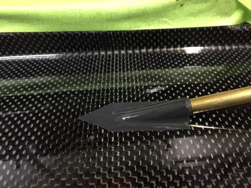

      Thx. I actually had to sand the stuffing tube epoxy and skim coat it because it was a good bit darker. Easier to do that than the motor mount. I was getting ready to sell the hull and start over had it not turn out right. I'm just too picky.
      My father in law has a heat treat oven so I may take you up on a blade or two. I just ordered so west systems so I'll be trying it on the shocker and cheetah.
      Before:
      After.

          Thx! It'll definatly get there. Truth be told, if I finish the boat before my 2250 arrives then I'll throw a 1521 in it and see how it runs. I'm paying more attention to details and mating efforts to cut drag where I can so it should be a touch faster than my other one.
          Not sure this makes much of a difference but look how much smoother this one is. This is the stuffing tube exit.
            • 7673

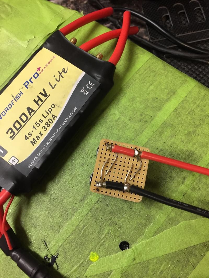

              Cap bank made while I had some down time.
              And waterproofed.

                  Very nice cap bank
                  --Albert Einstein
                    #69
                    Very nice cap bank
                    Thanks! What do you think about that monster sitting next to it?
