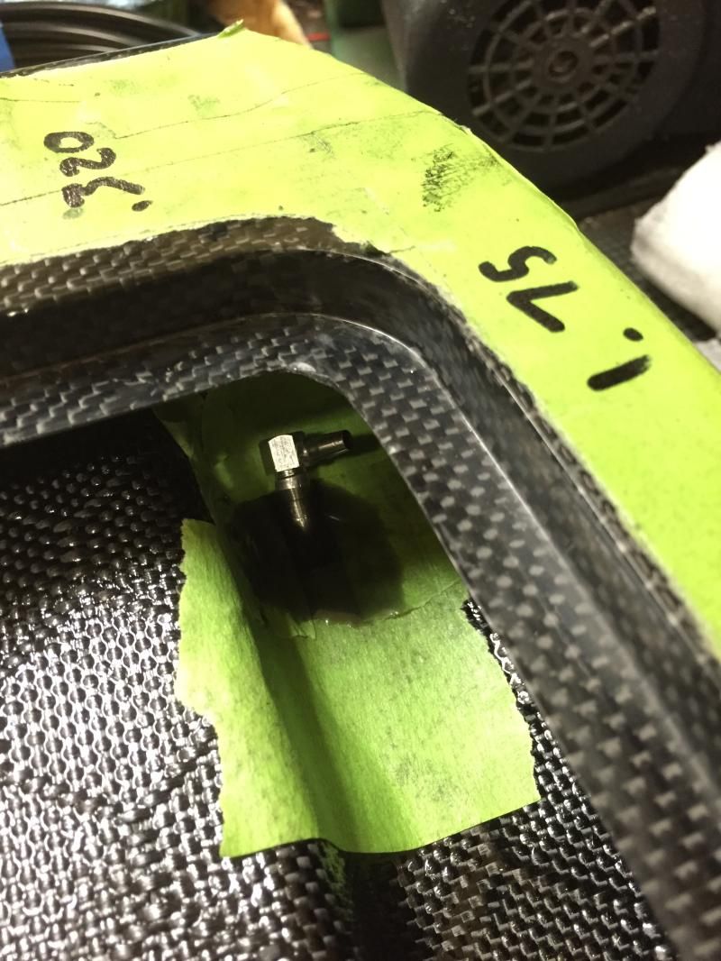

                      So after figuring out it may not be easy to get the cooling hose on I decided to change it a little.
                      And mocking it up
                      And epoxied in. I figured how to tint the epoxy black and still retain its strength.

                        Tape peeled

                                #90
                                Is the water pickup tube only on one side? And how does it look on the underside? I hope it's not just the tube sticking out!
