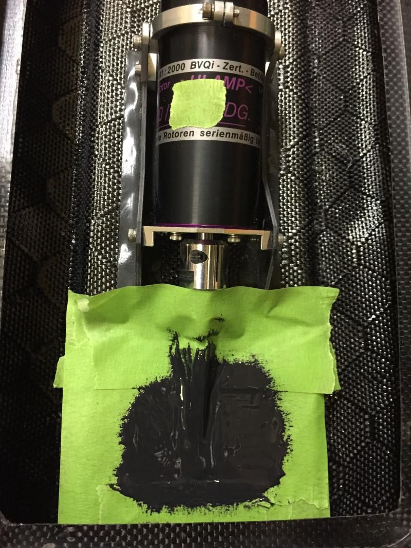

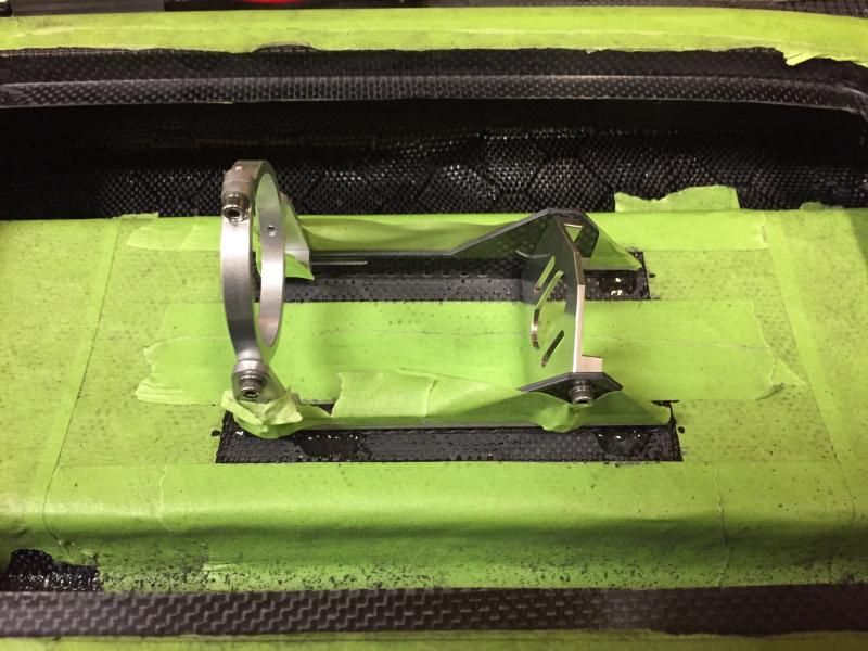

        Mount tacked in place.
        And epoxy flowing

              And 4 hours layer we peel the tape while the epoxy is still semi soft

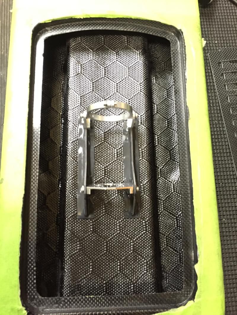

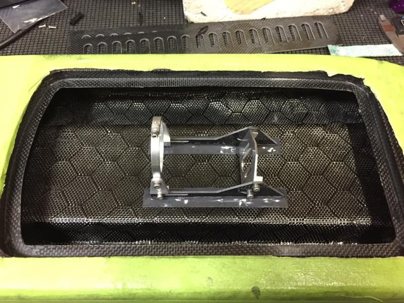

                    Motor mount looks good!

                      Thanks! Be watching this evening. I have a different idea on the stuffing tube mount I'm going to do. Will look better and be stronger

                          Didn't get to this as early as I had planned. I did get the pass through for the stuffing tube done tho. I'll have to get up at 2:30 to peel tape lol. I have to wait 4 hours before I can peel tape.

                            Is this some special masking tape you're using? Or just generic stuff from Lowes, etc? I find that my epoxy goes right through whatever tape I'm using.

                              Looks like frog tape.
