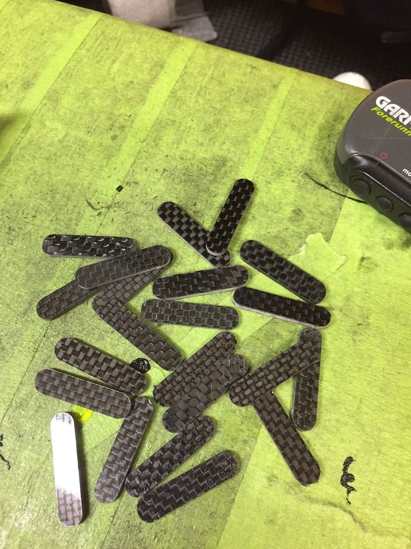

            Building mostly cats, the tray fits from tunnel to outer wall and contacts all the way down (of course after narrowing them on the belt sander) and are epoxied all the way down. On cats that have a much wider sponson (cheetah) I've used the tabs in conjunction with glueing to the tunnel. I'll be making my own trays soon on my CNC router so I wouldn't have to worry with tabs anymore. Pm me your address and how many tabs you need and I'll send them to you.

                            Luck....I found you a couple. This should do. I'll get em in the mail for you maybe tomorrow.

                                Thank you sir!
