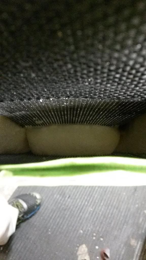

      I put two part foam in the hull. I did the two sponsons first then the center. Left room for my cap bank.
      I ran the foam Seal around the hatch opening. I had to cut the rails narrower down the sides because 3s packs would not go. At all.
      Made the servo mount. Epoxy is setting right now to hold it in place.
      I'm debating if I'm putting foam in the hatch. With bolts, if the hatch comes off.... I've got bigger problems. So I'm not sure if its worth it. The rest of my parts should be here tomorrow. Looks like Maiden voyage will be this Sunday if it doesn't rain.

        Here's the foam

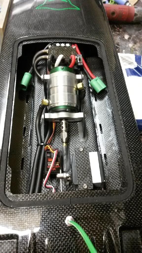

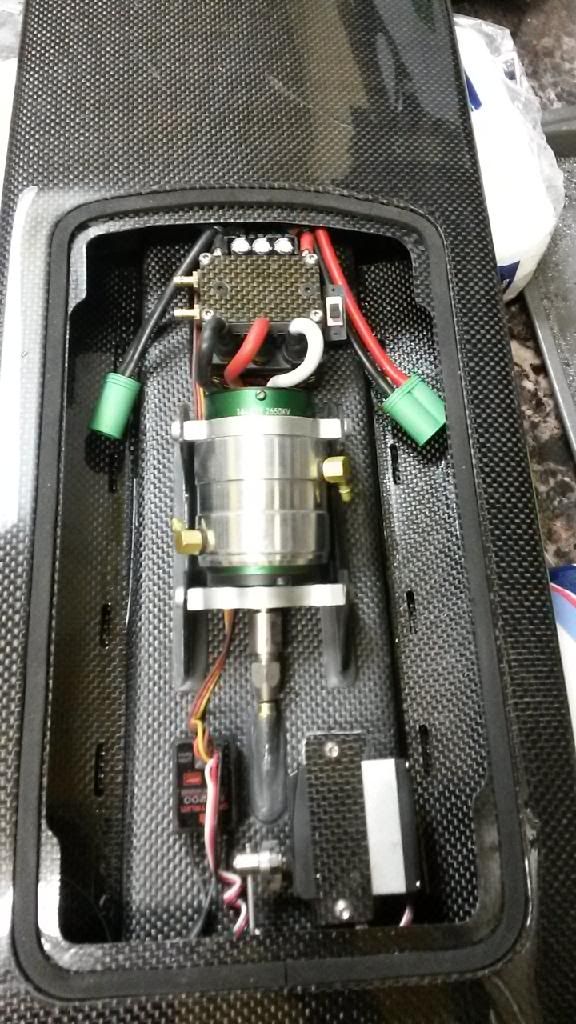

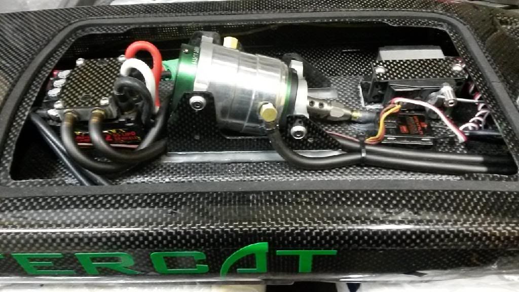

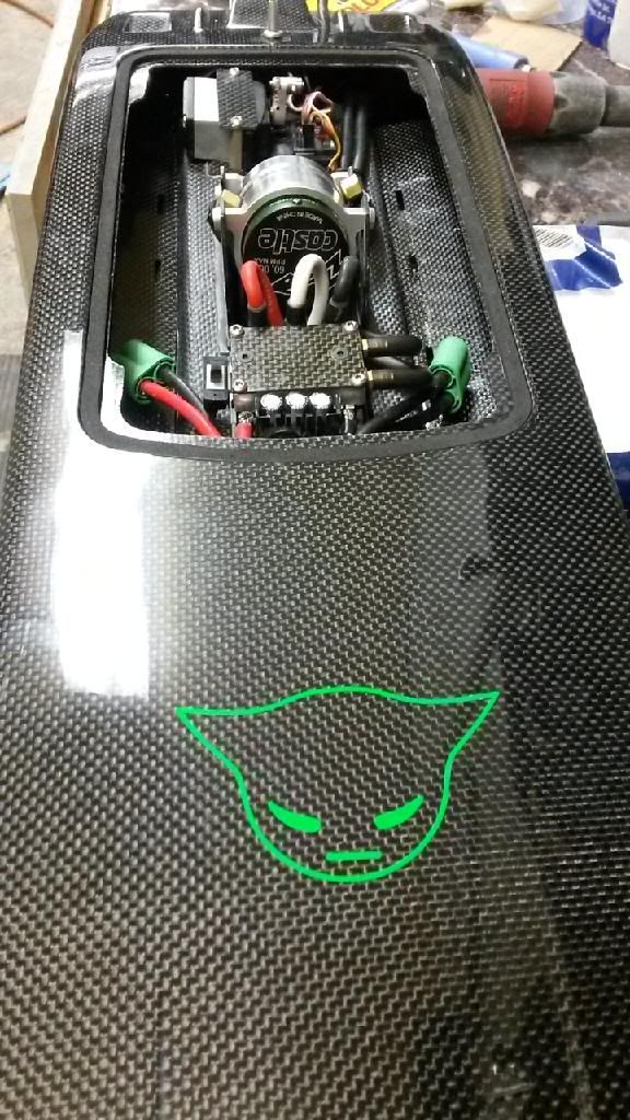

              I got a good bit done tonight. Installed everything and wired everything up. Installed antenna holder, bulkhead cooling fitting. Finished the steering linkage. My cap bank came in today so I soldered it on the esc. I bench tested it, works perfectly. I think im going to run it on 4s first. I'm waiting on epoxy to dry on the hatch... I added a layer of cf. It's pretty much finished except holes drilled for hatch bolts.
              Pics
              ESC after wire upgrade, cap bank and castle connectors
              Stuff being installed
              Finished
                #67
                More pics.... Noticed I had to cut the sides to fit 3s batteries in it...

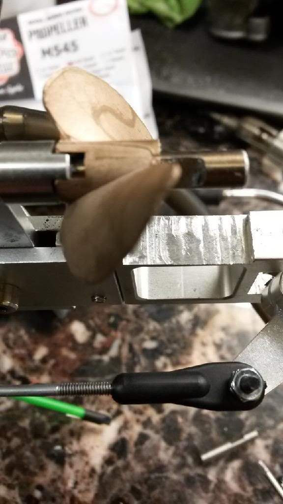

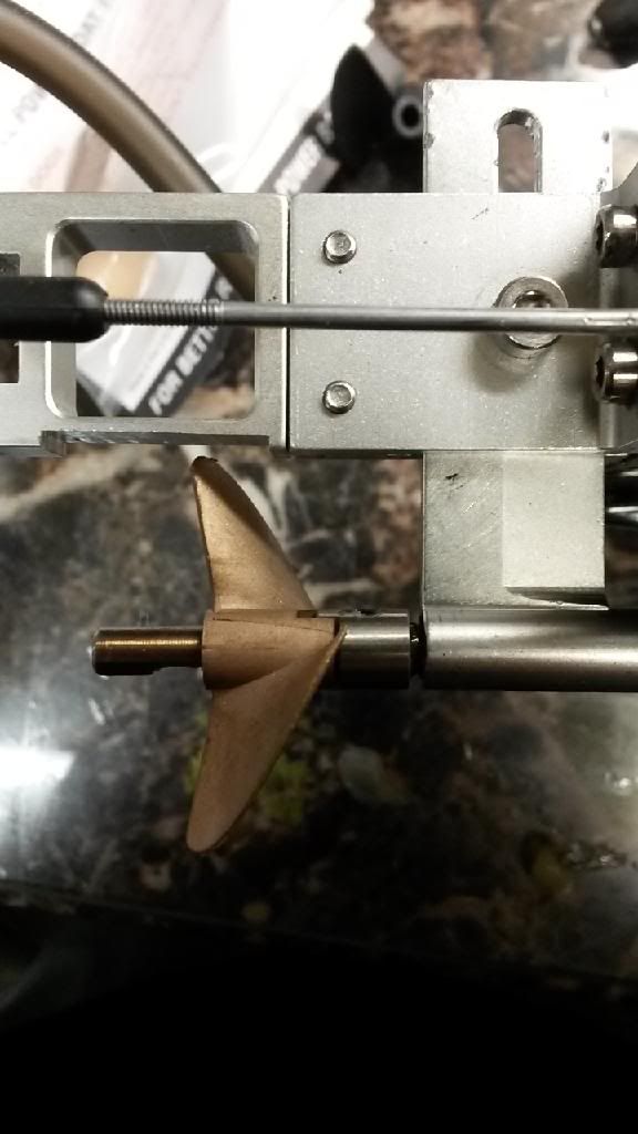

                    My props came in. Man I couldn't even fit a 38mm prop on it be a use it was hitting the rudder bracket. My solution? Milling machine....

                      #70
                      How about some standoff type pieces to offset the rudder? That's some super drag in the thrust cone...
                        #71
                        Not a bad idea.... I think I'll do that
