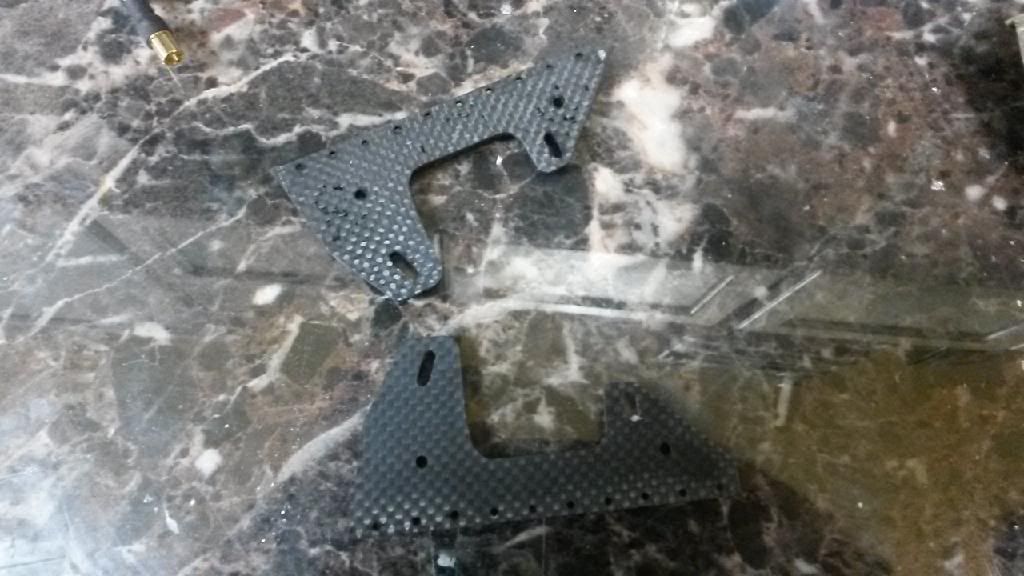

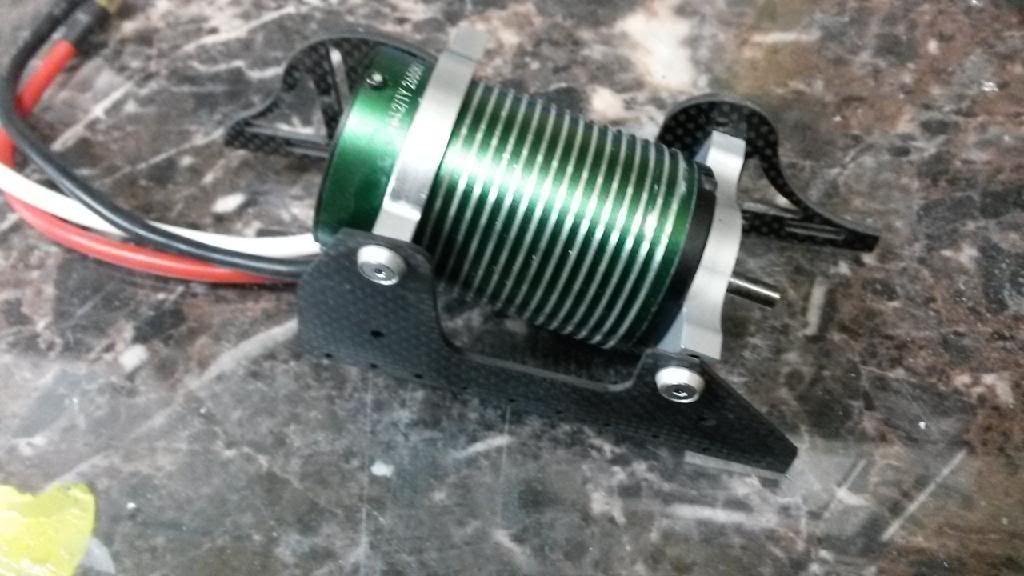

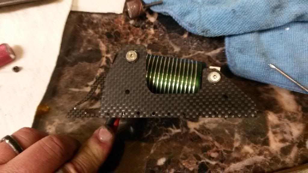

                                #30
                                I mocked it up tonight. No go with the motor mounts I have. So I made my own. The mm2 esc will fit if I make my cooling block thinner by a tad. Wont be a plate made to hold the esc in this build because of its size. I may use something else, I'm not sure yet. I'm just trying to shoehorn this big ole motor in it. Right now I'm fitting the 1512 motor but ill have room with the 1515 because of the mount I made. The CF I used wasn't quite perfect so I had to block sand it a little and put a nice finish coat of resin on it. Pics
