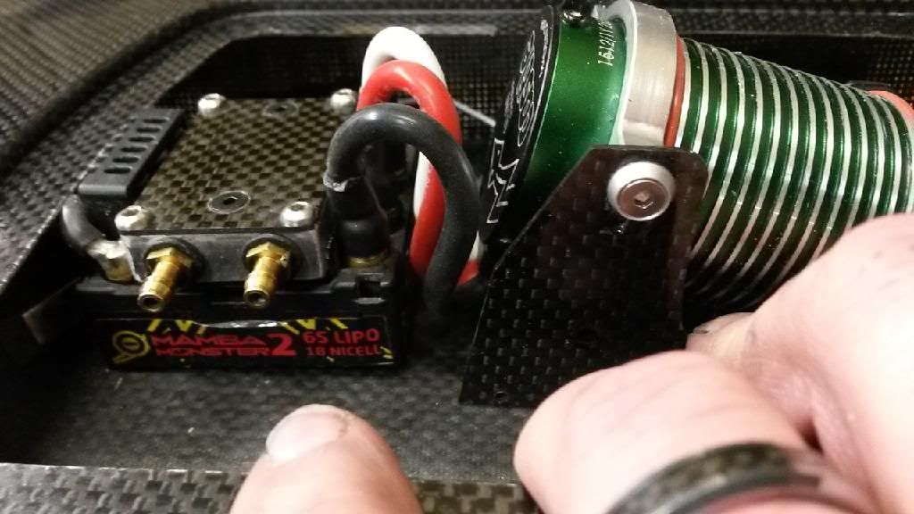

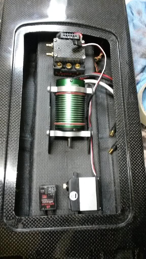

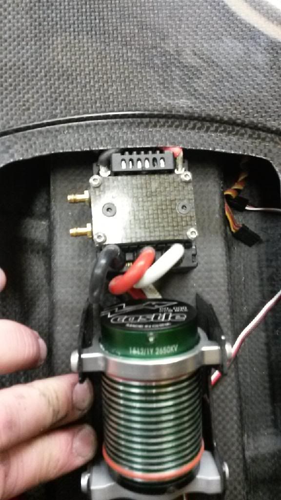

              Mocked some things up tonight.... I think its gonna fit well. I had to cut the fins on my esc to lower the cooling block. Shortened the motor wires a little too. Assembled the motor mount.

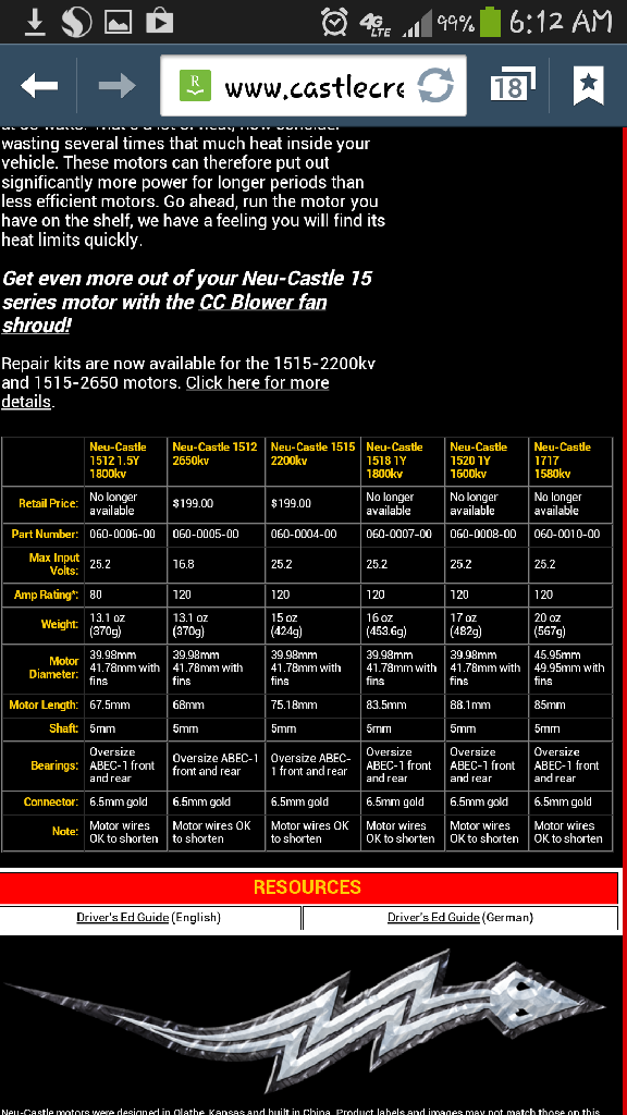

                Why would you cut the motor wires , never ever cut the motor wires ......this alters the motor ....anyone else know any different chime in please.

                  Well because on castles website it clearly states is ok to shorten them. Also I've done it numerous times and never had a problem.
                  Read the note at the bottom of the chart

                    Castle motors are one of the few that can be cut. The wires are not part of the windings like Leporad, TP, and others.

                        Plans have changed.... I'm going to run a 1800kv 1512 castle instead of the 2650kv version. More flexible battery setups

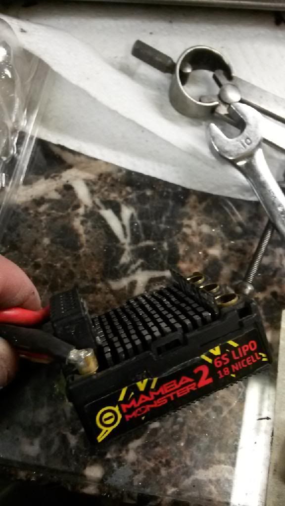

                          I would de-case that mamba, take off the heatsink and put the cooling block straight on on the fets, use some thermal paste (lots) to help heat transfer to the cooling block. Keep it dry and Id say that will serve you well, they are a pretty damn tuff esc those.

                            I had to shorten the fins on the esc (cringe I know lol) because with the cooling block it was too tall. What a pita! Lol I tried milling them first. Too thin. They were moving and bending all over the place. I ended up using a 1" sanding disc and then machinist filing them flat perfectly

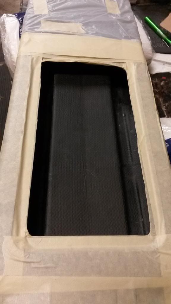

                              Guess what time it is........ Yep.... Inlay time. When this cures I can start putting it together!
                                #45
                                Fixing to lay epoxy
