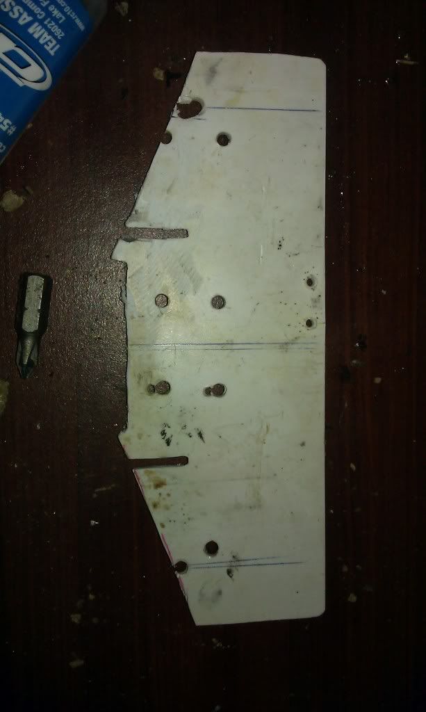

      Ok so i made a template for the transom to make a plate. I made a plate and now im thinking about how to keep it there.. what kind of stuff should i use to put the plate on the inside of the transom...
        • 7673
        #48
        Do you have epoxy and some sort of clamps?

          I dont have clamps or epoxy but i can get access to them if i need them.
            • 7673
            #50
            You have made the plastic to fit inside? I would sand to rough up the inside of the transom and the mating surface of plastic.Sandwich epoxy between them and clamp them together.Put a black garbage bag down to catch any drips.It is my finding that epoxy does not adhere to Garbage bags.Wipe the excess epoxy out from inside as you don't need too add the weight. OK?

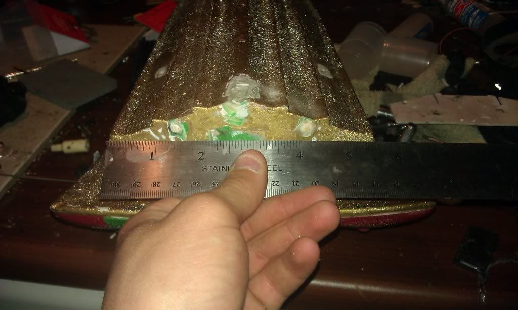

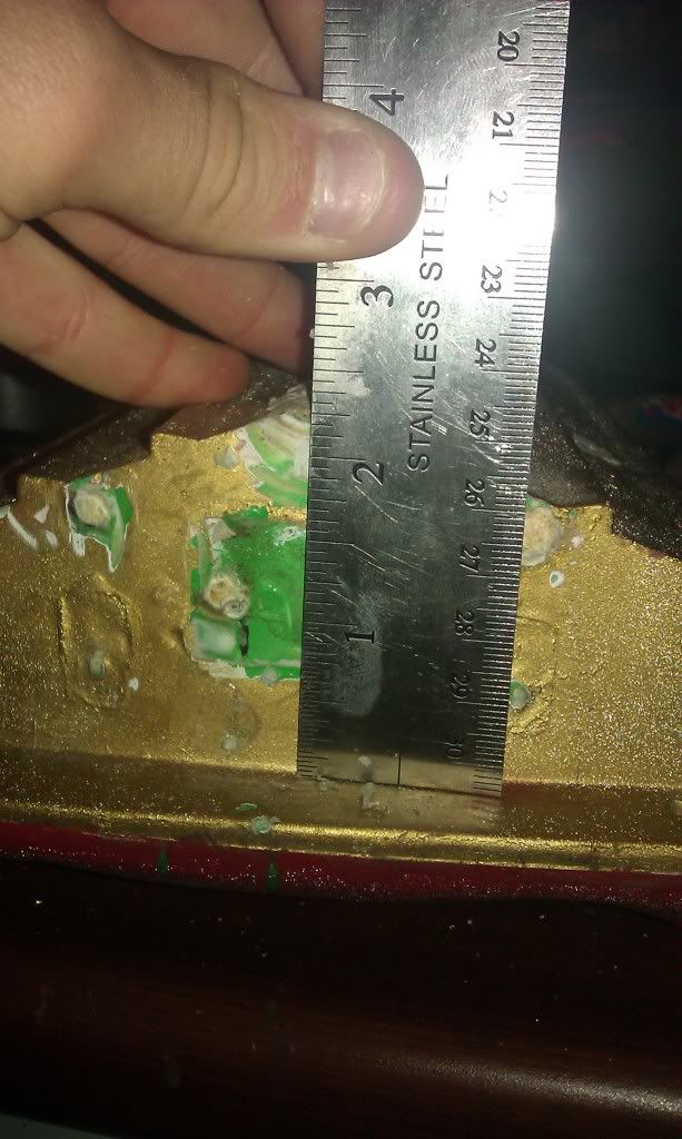

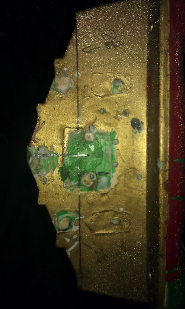

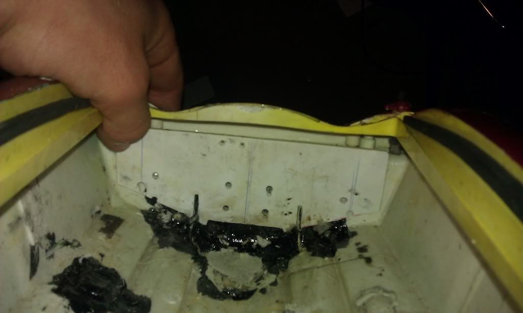

                Got some measurements and pictures coming up..
                From side to side, its 5 and 13/16in...
                I have a picture coming up.. i drew a line across. Divided in half, went down to find center of the transom.
                Then rose up 5mm to find the hole for the drive line. Any questions just ask.
                • masonis1
                  If you cant control it 👍👍
                  • 1173
                  #53
                  plate for transom
                  in hull
                  measurements
                  more
                  final. Correct me if I'm wrong
                    • 7673
                    #54
                    That transom is rough isn't it.If it were me I would smooth it with sandpaper and then make my marks.You'll want to carry the center mark up for the rudder/strut bracket.
