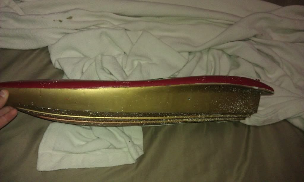

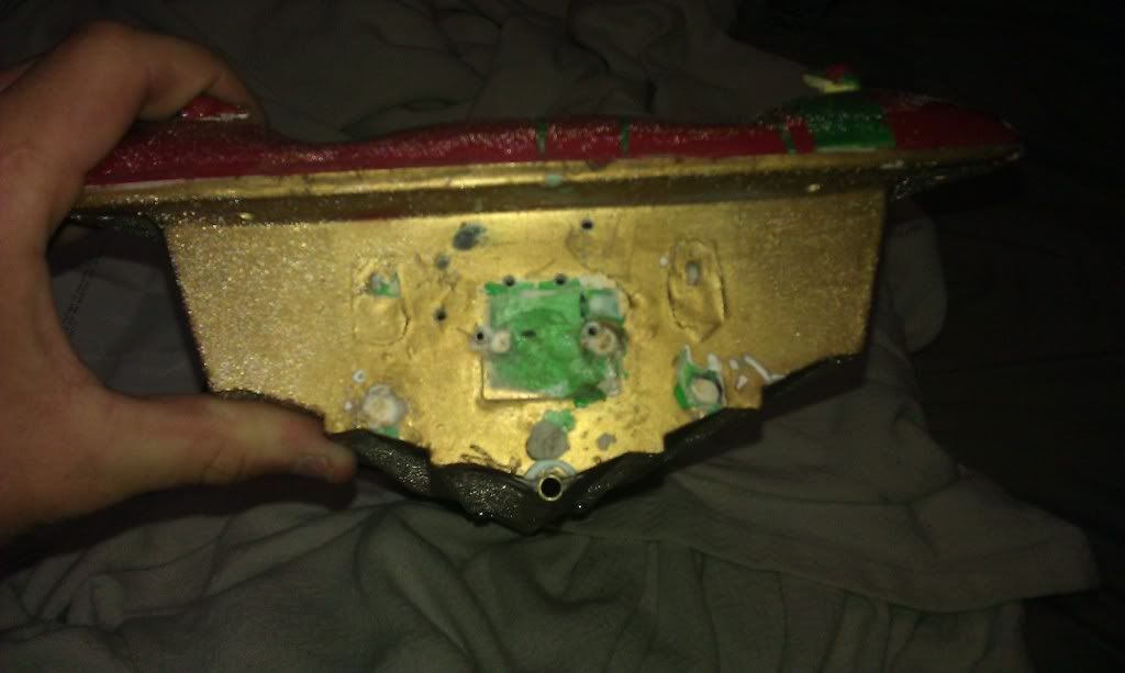

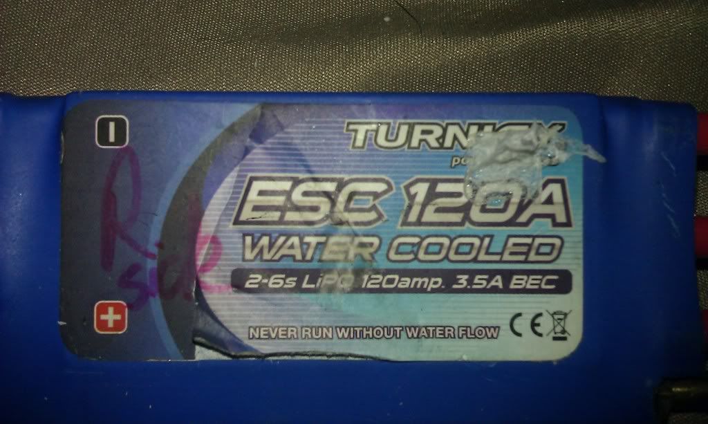

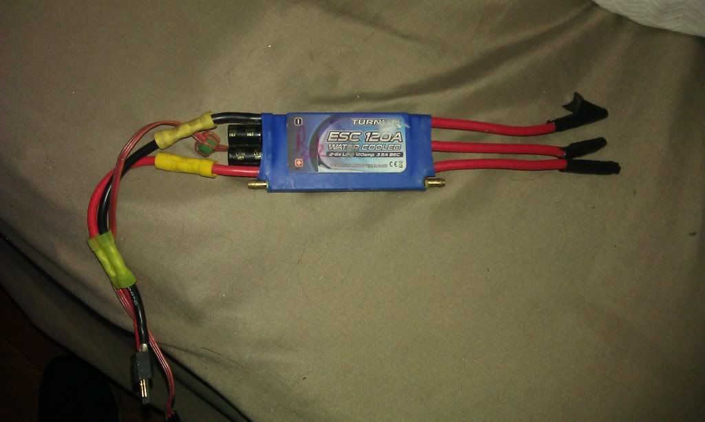

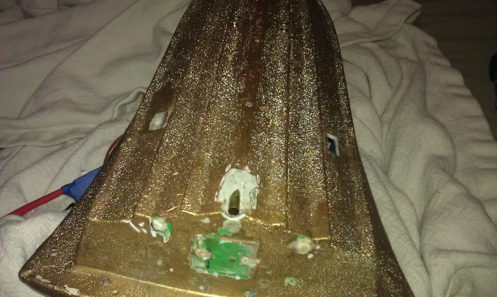

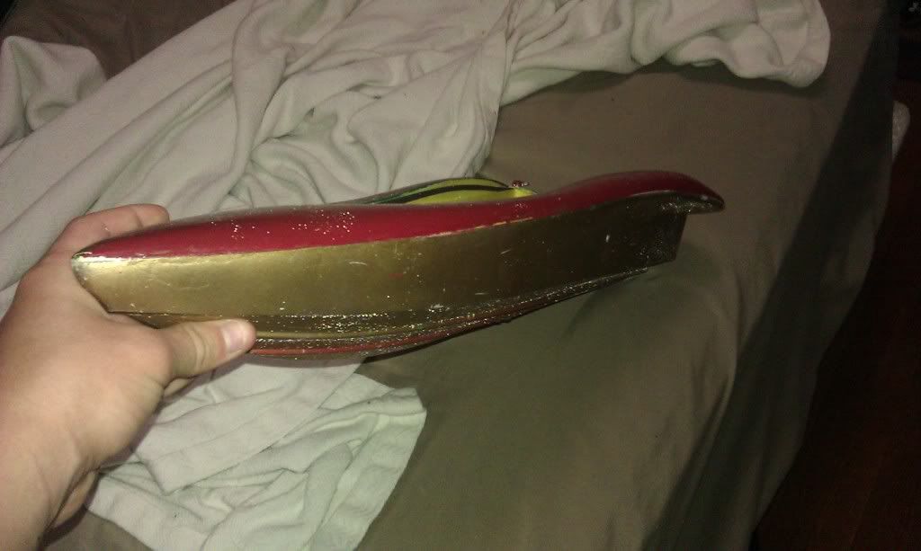

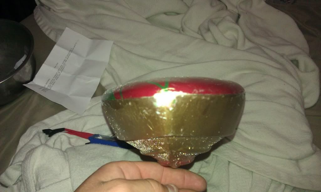

    So here it is.. i got this cheap old boat from some online place for 30 bucks a while ago... Its a deep v as you will see in the pictures... It was brushed twin motor. I am trying to convert to brushless. Well now i have it where its 1 motor and a rudder. So... Heres the parts list.
    Turnigy 3656 2700kv motor
    Turnigy 120a esc
    Turnigy nano tech 3s. 45-90c
    Traxxas rudder assembly.
    Boat hull
    I tried this in many tuning options.. either way, it sucks air... I have reved it up very low sucked air... Wow right! I have about 4 different props of different pitch i can try. Havent tried them all but i am willing to re drill holes... And start fresh. I want this to run good. Help me know where to drill and what i can do. I need help choosing shafts, and other parts.
    Now the pics...

      We need a picture of the rear end as it is set up now to assess what you have....

        Ok. I will get some better pictures.. i am willing to re drill anything and start from scratch

          How long is the boat?
          Post some pictures from the top to see the room you have inside...

            It is around 28 inches if i remember correctly. I will have pictures up in a bit

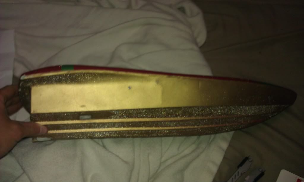

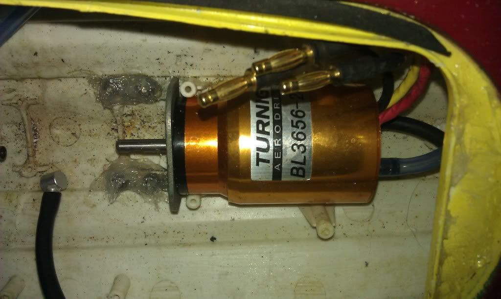

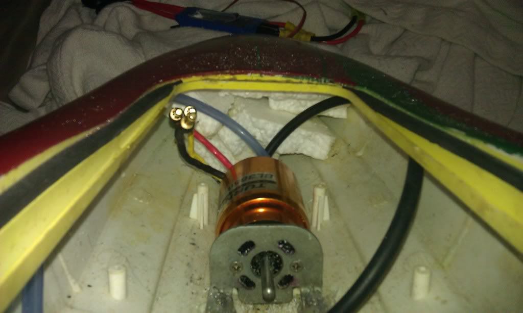

              more pictures

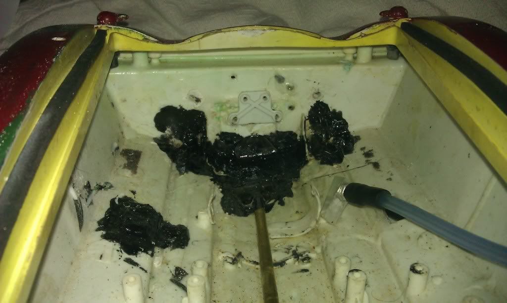

                i know its dirty and a lil nasty inside. the black is abs to seal up some holes and its been sitting a while so its kinda dirty..

                            make sure the prop is not right against hull, move out more
