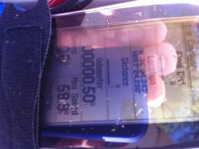

                Today was a good day. Found the right setup. 58.9 MPH and stable.

                  Made some adjustments. Pulled 58.9 MPH 2 times off the GPS. Boat was running really well. I still have about 5% of an issue with chine walking. But it was dependent on my driving. If I gun it hard it excites the instability when coming on plane and keeps doing the chine. If I come up one plane with a smooth throttle response it just gets up and goes nicely.
                  link
