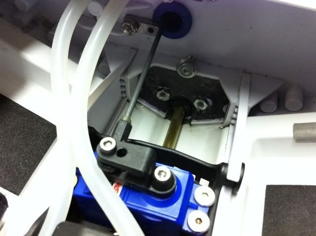

            Oh, I forgot to mention that adjusting the inside right trim tab (looking at the transom) will be difficult to adjust. The rudder and adjusting bolt are competing for space.

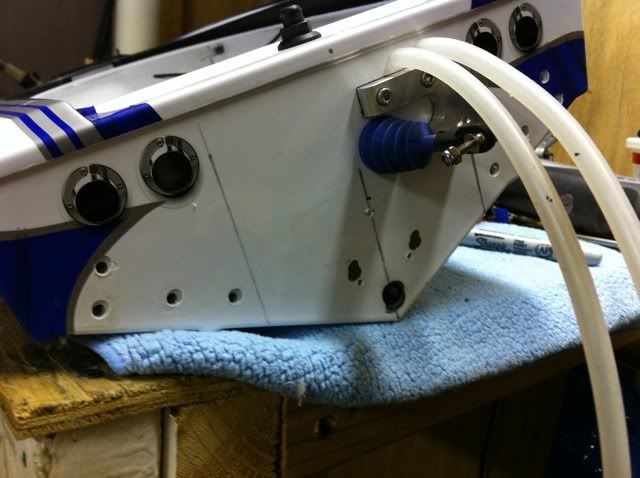

              Here is some food for thought. Ive noticed some spartan owners that have upgraded boats say that their boats run well on 6S and are not chine walking. Then some that complain that they cant get it tuned out. Then im sure some of us have seen pics of crooked holes for mounting the hardware. I noticed my strut looked like it was slightly crooked in its stock location. If you move the strut up or down and its not dead straight it would kind of angle a few slight degrees to the left or right. I wonder if thats causing some of these problems?
              When I get my new strut Im going to dead center it on the hull and see how it goes.

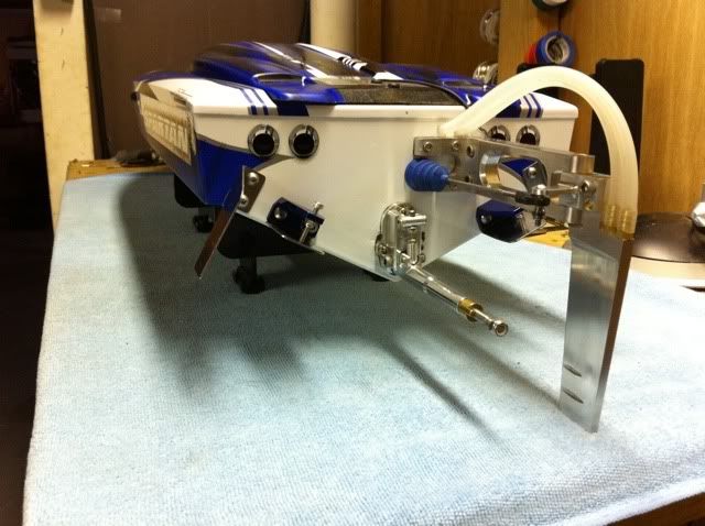

                        Speedmaster 3/16 strut/stinger installed! Wire drive installed. Bench tested. Great! Now to put the rest together. Hope to try tomorrow.

                            #148
                            that strut looks good man!

                              #149
                              it does look good,
                              How well did did the mounting holes line up with all the plastic ribs etc on the transom.
                              Kevin

                                #150
                                Top bolt came out in odd place.
                                I would of put a spacer there but don't have one. The washer is grabbing pretty good though.
                                Maybe I'm getting sick of this boat I'm getting sloppy.
