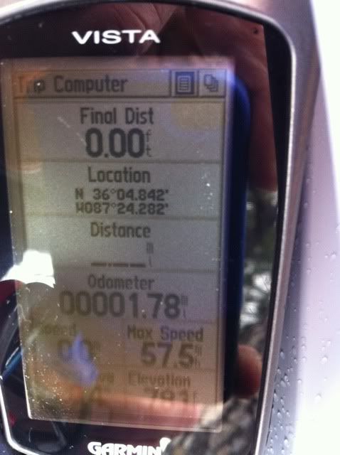

              Hit 57.5 this morn b4 work. Moved weight back about 1.5 inches. But it's becoming unstable again. Going after work to try something else. Maybe try dropping the strut down to level. It's just slightly prop up right now. Or place the gps up front on the left. Idk. Open to suggestions.

                  dropped the strut back to level. didnt help. I moved the batteries back more forward too and then that didnt help. very weird. I left the batteries forward then started pointing the prop back up and it got better. this is nuts.

                    57.5mph!Thats sweet.

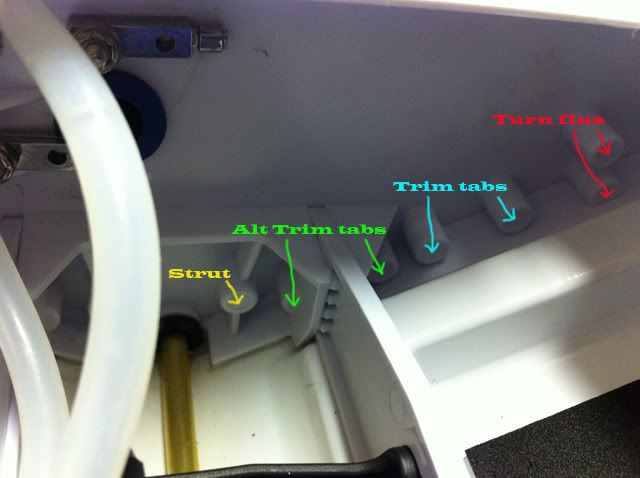

                                #105
                                Look what I found.
                                Alternate mounting holes for trim tabs molded into the transom. They just are not drilled out.
                                I noticed on the prototype that traxxas has that there were holes in the back of the transom closer to the strut. I figured it was just from testing different setups.
