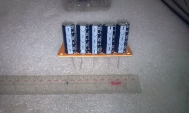

      I'm making a Cap Bank today. 5 x 2200uF 50V soldered together on a PCB. This is enough I hope?
          Stephen
          I might just run my MG as is with the colors then repaint with your color when needed. I suspect my color to be flaked off anytime soon anyway hehehe.
