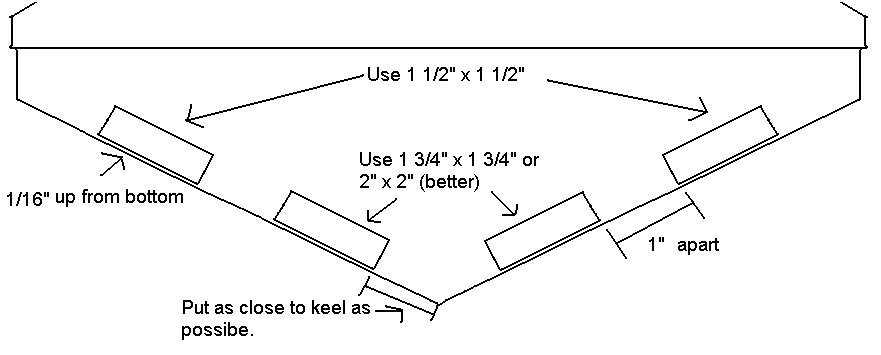

                            #208
                            Thanks Rafael, by tabs near the keel, what do you mean?
                            I know this is out of place and has nothing to do with the Zelos 36, but thought posting this here may help someone else.
                            Keagan, this is not my picture and I'm only using as reference to your question regarding mounting another set of tabs closer to the keel on the Voracity 36.
                            Ok, back on topic!
                            Rafael Lopez
