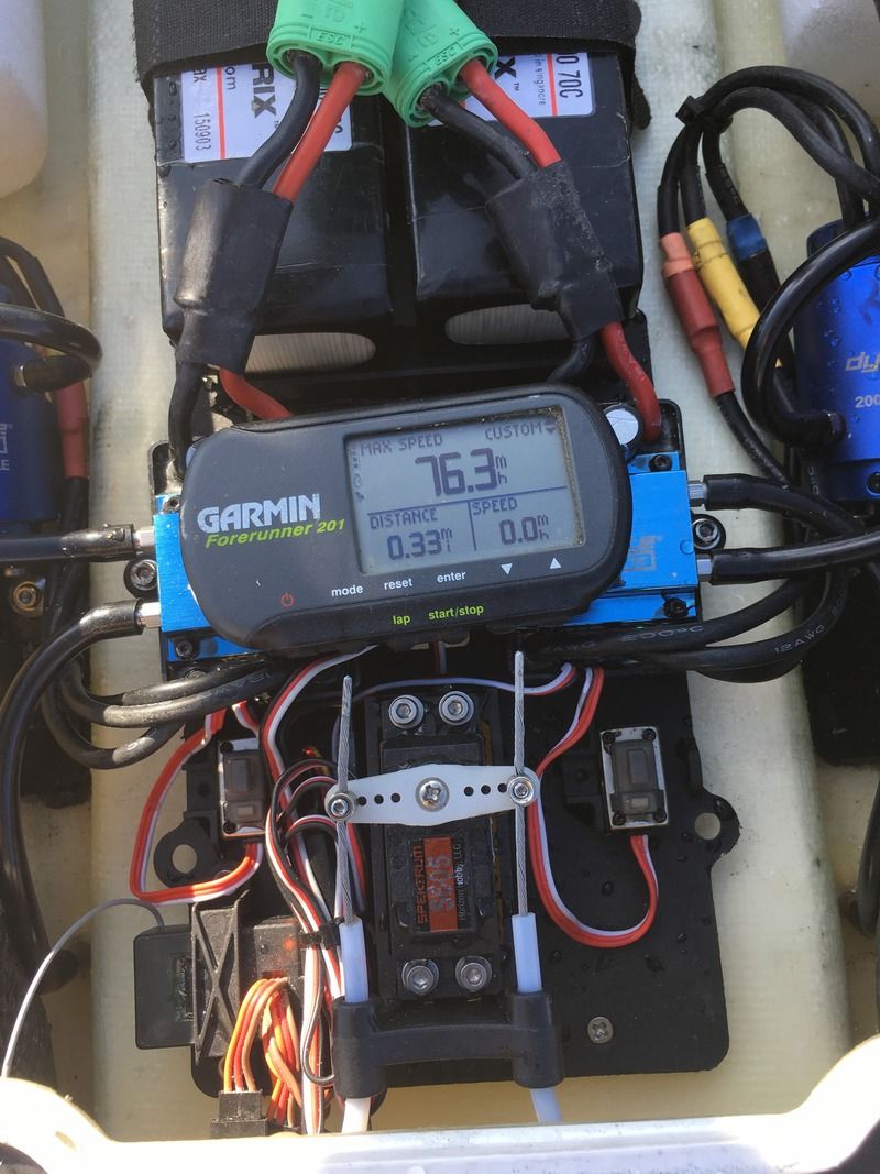

            I've got some good useful info for you guys that wanted to know about timing changes and their effects on speed. I ran it back to back making only one pass (to not drain the packs unnecessarily) and recorded the speeds.
            So here's the results:
            3.75 degrees went 74.7mph
            7.5 degrees went 76.0mph
            And 11.25 degrees went 74.8mph
            I didn't go higher or lower than that because conventional wisdom told me what's the point lol. So the sweet spot seems to be 7.5 degrees which I think is the factory timing. For the record, I've never seen any increase in speed from timing except in this case. I'll admit I never changed timing at the lake which is probably why because conditions change day to day and so can speed. However, this boat has clicked off speeds within .2mph on three different days with totally different conditions on one of those days. I must say I'm still impressed with this boat.
