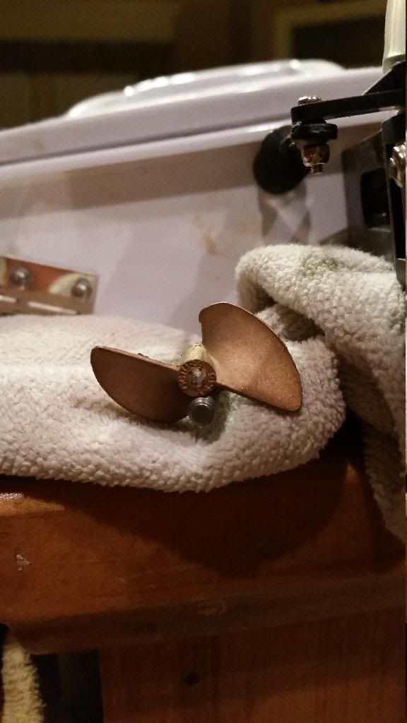

            Sorry bud. Like I told you, it's not gonna work. I won't keep arguing with you. That prop you sent a link for is for a 1/8 shaft. If you have a Shockwave 26 brushless, you have a 3/16 shaft. I have the same prop. I did the same mistake your making. That prop works with the brushed version. I've had both. The brushed version has a smaller shaft and the motor turns more rpm per volt. If you have a v3 brushless, I'll bet you 100 bucks I'm right. Here's your proof....I just took these pics just for you

                Sorry guy, but that's not true! I too have the brushed version (V3), uses the same size shaft as the BL version, .150" with 3/16"(.187") prop shaft, both come with this prop... http://www.proboatmodels.com/Product...ProdID=PRB0151 - I attached 3 pix of my shaft for your review - they're under your boat pix.
                Proboat (not provost) lists this one as optional... http://www.proboatmodels.com/Product...s&SubCategory= - and - http://www.proboatmodels.com/Product...ProdId=PRB0650 - those are the same props that come stock on the IM31 (v1 & v2), I have the v1.
                The PB prop is the same thing as a Prather S215... http://www.offshoreelectrics.com/pro...i-prather-s215 and is very close in size to an Octura x640 - 40mm(1.57") 1.6P x 1.57" = 2.512
                If you have a v3 brushless, I'll bet you 100 bucks I'm right. Here's your proof....I just took these pics just for you...
                @Fischetti11358... you might want to listen to what kfxguy is trying to tell you cuz you will loose the $100 if you don't! I don't care what some JackMeHoff on another forum told you, they're wrong!
                He's wrong bout the brushed version shafts as you can tell from the attached pix, but that doesn't really matter since we're talking bout BL boats anyways.

                  I guess I'll have to wait and and see. But like I've said, I've seen numerous posts about the x435 prop working. Can't I just drill out the prop to make it fit my shaft?

                          Jw, your right. Now that I think of it, it was only the steerable out drive version that had a 1/8 shaft. My bad.
