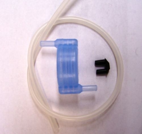

        I also added the silicone water jacket. the inlet and outlet were opposite each other which wouldn't work. I had to correct that issue.
        Here's the result

              Part # gnd-4195
              Fits 20mm to 28mm Diameter Motors. My motor is 28mm. Fits like a glove!

                        I don't understand what you mean when you say the inlet and outlet were reversed to you fixed it. How did you fix it, or what will I need to do?
                        Get yourself a piece of K&S 5/32 brass tube.
                        Cut off one of the outlet tips on the jacket.
                        Drill a 3/32 hole in the opposite side of the outlet you just cut.
                        * The hole will close up with the bit removed, it's normal.
                        Insert the tube into the hole you drilled in the jacket let about 3/16 stick out the back and mark where the 2 water channels are placed on the tube with a pencil.
                        Drill 2 small 3/32 holes in one side where the pencil marks are.
                        Fill the end with solder to seal it shut.
                        file or sand the rough edges on the tube.
                        Insert the tube in the jacket positioning the holes in the water channels.
                        Cut the tube to length.
                        Done
