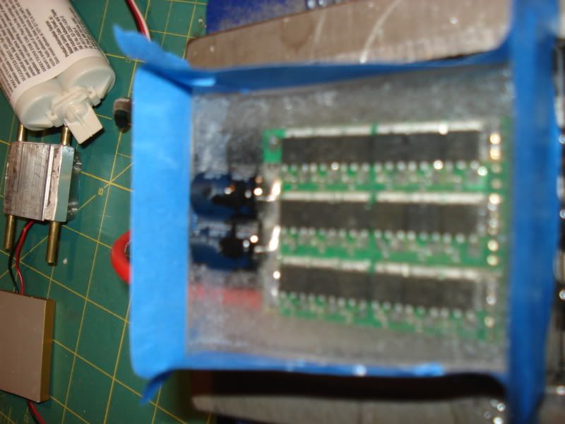

          I found 2 threads of waterproofing this esc, but I did not found very much helpful info.
          1. I will use the etti cooling plate.
          2.I have that 3m 270 epoxy.
          3.I have the thermal grease (what Steven sells)
          -How should I do this?
          How will that cooling fin/plate come off? -is it really just prying and pulling?(and breaking the esc at the same time )
          Do I first istall that etti cooling plate, then brush thin layer of epoxy everywhere, or do I first waterproof it and then add cooling?
          Is it better to dunk it in epoxy or just brush a thin layer on it?
          -but how can it be 100% waterproof if the esc is not totally inside an epoxy block?
          (Pic from this thread http://forums.offshoreelectrics.com/...ad.php?p=32945 )
          I do have 99% water free hull...but it only takes a drop of water ...

            What I did was:
            1.) Removed the shrink wrap.
            2.) Removed the heatsink. Save the thermal tape. It comes off pretty easily.
            3.) Coat the ESC thoroughly with the DP270 epoxy.
            4.) Once cured, block sand the tops of the FET's to get a smooth flat epoxy free surface.
            5.) Apply the thermal tape to the cooling plate contact area.
            6.) Apply a even layer of thermal paste to the FET's
            7.) Assemble and heatshink into place.
            That should do it.
            Others may have some suggestions.

                Originally posted by domwilson
                Forgot to mention, while the epoxy is curing. Go kick the neighbor's cat.
                I did that twice earlier today, so do I must do it all over again? -the poor little thing is so scared of me now that I dont think I can get close enough anymore.
                (if you see some fluffy cat that has size 13 nike in his a** , please get that shoe back)
                And does thoroughly mean that it should be done like this?
                or brush it well all over? (I only ordered one pack of that epoxy from Steven )

                  I brushed mine on till it was completely covered and no entrance way for water. This includes between and behind the caps. It looks like a epoxy coated brick, sort of.

                        Cute DHL girl just delivered my esc!
                        Thanks to Dom for pics and thoughts, but has any body else have different thoughts?
                        Still thinking that dunking it would yell waterproof and brushing would make it water resistant?Most of the temps would be on the fets so the rest should be fine inside epoxy block
                        So come on, what have rest of you guys done and has it worked?

                          Don't know if you can call it brushing or dunking. I used a popsicle stick to make sure it was completely covered and filled like a brick.

                            Ok, so I guess it does not matter then witch way I do it
                            the esc has worked nice and for how long Dom? ( did you got it wet once or twice?)
                            Is that epoxy 1.7oz /50ml? -will one be enough or should I order more?
                            You have kept the 12awg wires? -2 pairs?

                              Oh I got it wet...very wet. I had mine drip dry from applying the epoxy over night by hanging it from the faucet in the kitchen sink on to a paper plate. Next morning, got up, cleaned the sink with this thing dangling from the faucet. Water running over it. Yes I was tired!!! Dryed it off with a paper towel. Then tested boat in the pool. Worked perfect. This was more water than it would see in a boat. So if water under pressure can't harm it, I don't think a few drops in the hull will.

                                That should be enough epoxy. I kept the 12 awg wire as I don't think the amp draw is that high. I currently don't own a Eagle tree. Was running a hex 120 before.
