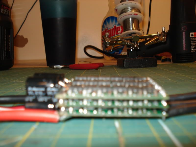

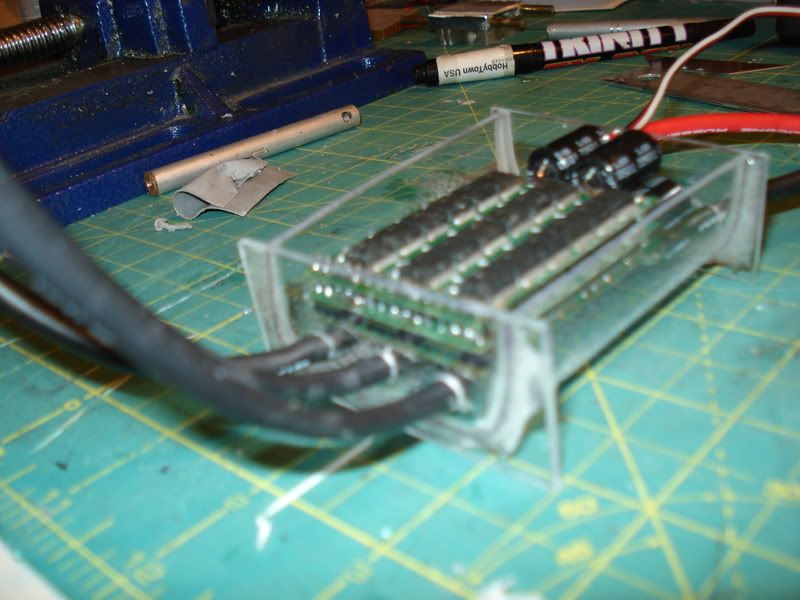

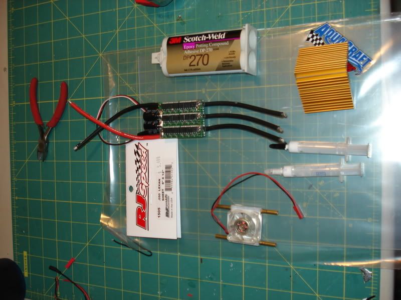

    I figured some one may be able to use this info so here it is. With this unit being 3 boards I needed to take a different angle @ it. No copper this time. I have cooling plates, 2 heat sinks and a fan. I made up a little mold out of some .050 lexan. Next time I will bake it in the oven as I was told. The heat gun is to uneven. It still was usable & some sanding will clean it up. Quite a bit will be removed during the clean up leaving a much smaller footprint than the 70's. The lexan will pop right off the epoxy and the 5 minute DC I used to seel up the wire holes. It's really easy to work with. just score it and a little bend breaks it off straight every time. I'll post the finnish pictures tomorrow.
