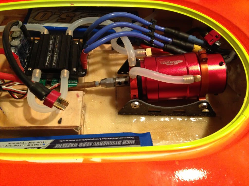

          Well I didn't document the next steps too well..... I ran into a ton of issues but figured everything out...
          I reinforced where the motor mount is for shlts and giggles
          Then pretty much put everything together.

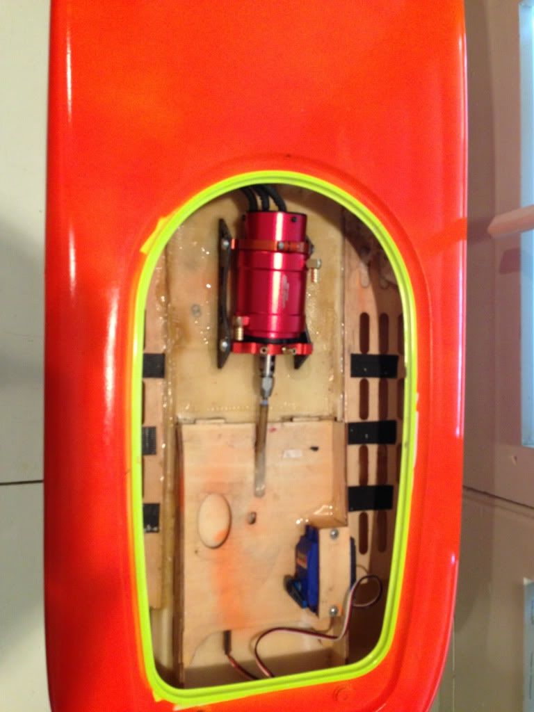

            Looks good Gabe. Did you remove the wood under the original motor mount? How did you do that?
            • Gabe_k
              • Jan 2012
              • 126
              #51
              Yes, that was the first thing I did on the first page.. I just sorta pried it and tapped it with a hammer. It came out pretty clean.. I also had to remove the stuffing tube support so I could angle it down more to line up with the motor. I didn't want to at first, but it's actually better since now the motor sits lower and I can put the canopy seal on without it hitting the motor. I know you said that you don't use yours due to clearance issues

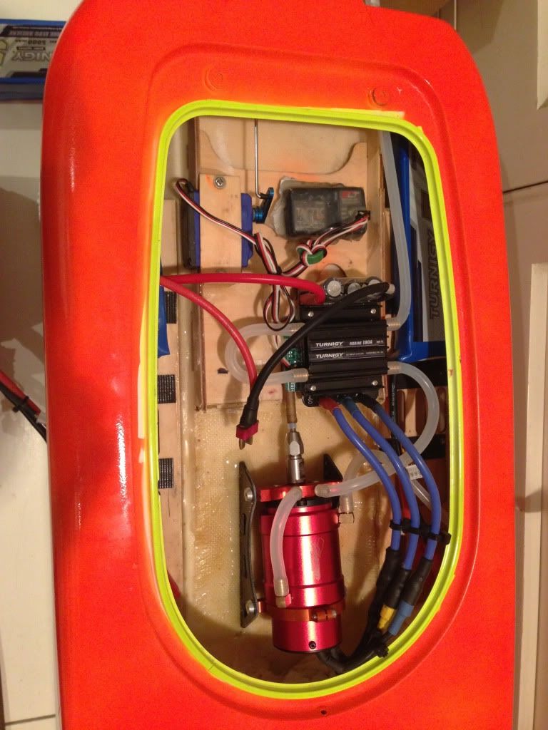

                  It'll look better that way... Here's some pics of how mines set up
