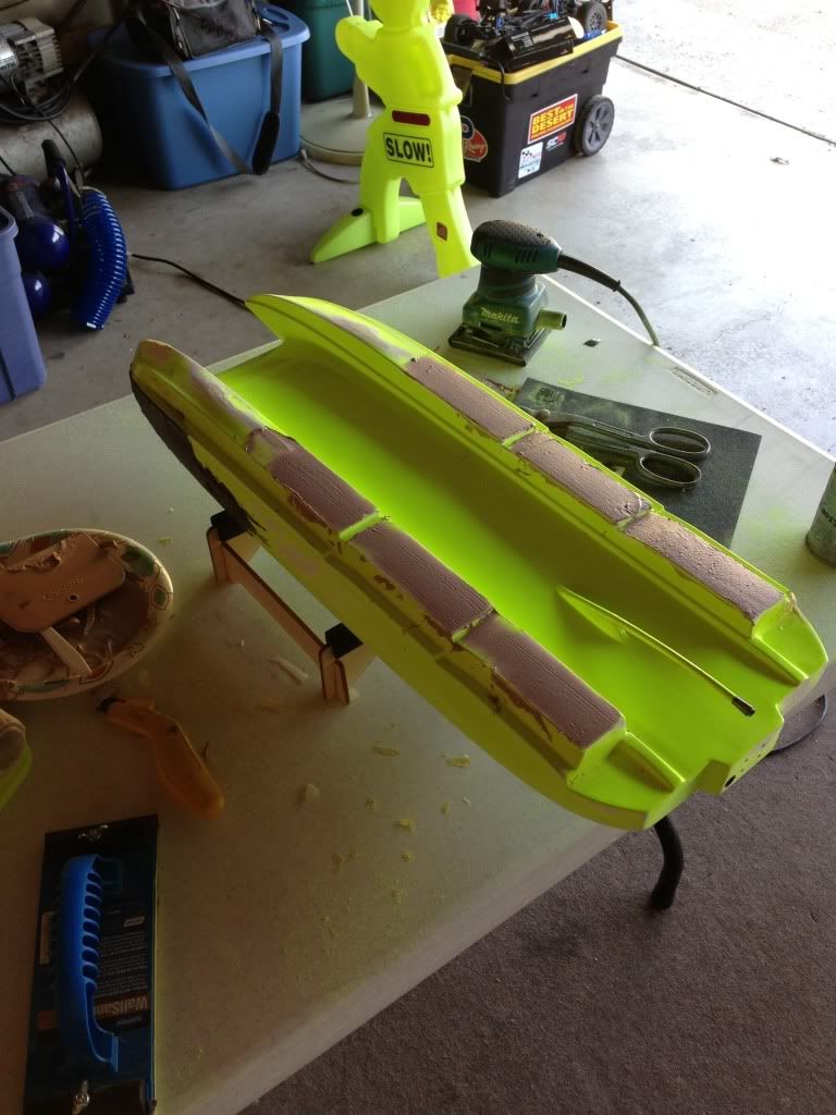

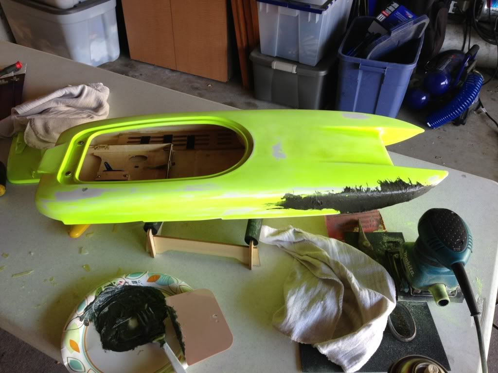

    Alright, so apparently you can't put epoxy on top of epoxy.. Lol so I managed to take as much of the original epoxy off as I could then sanded the boat down. I filled in the split with bindi glass

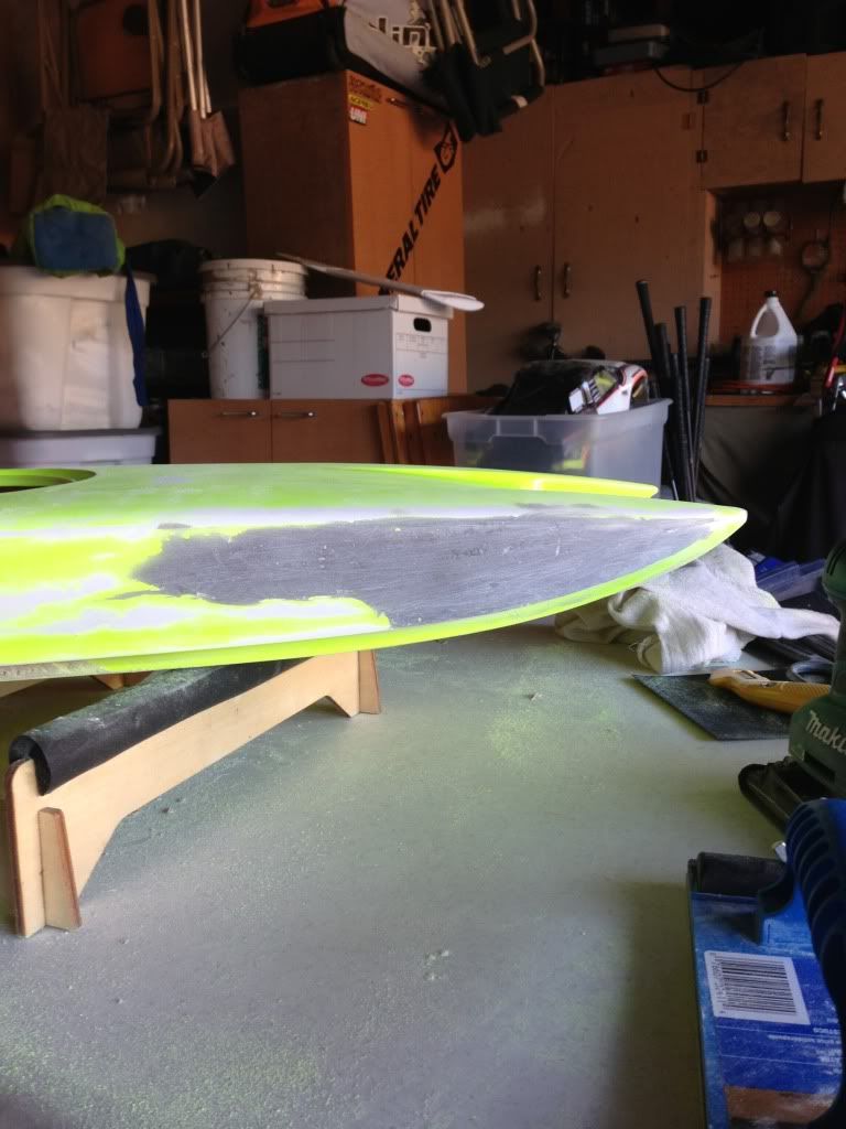

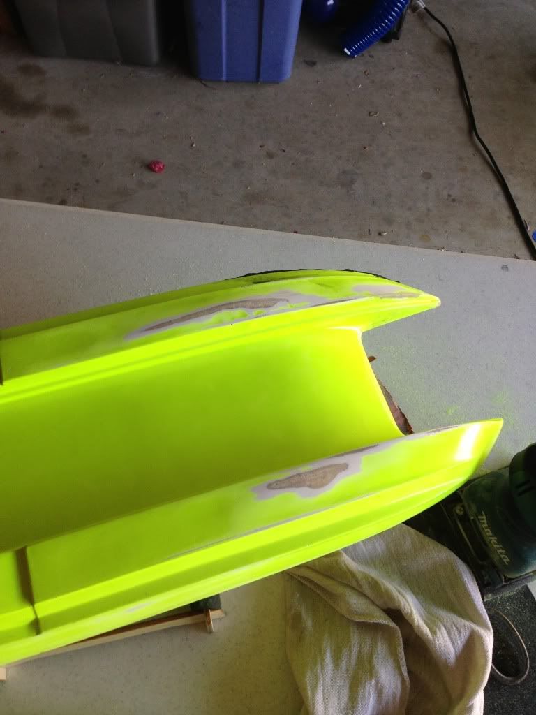

    Then I started sanding the sponsons since I have nothing else to do.. This is how untrue they are..
    Filled with bondo body filler..
    Now I'm waiting for this to dry up a bit so I can start sanding things down... I don't know why but I think I have more fun building than driving...

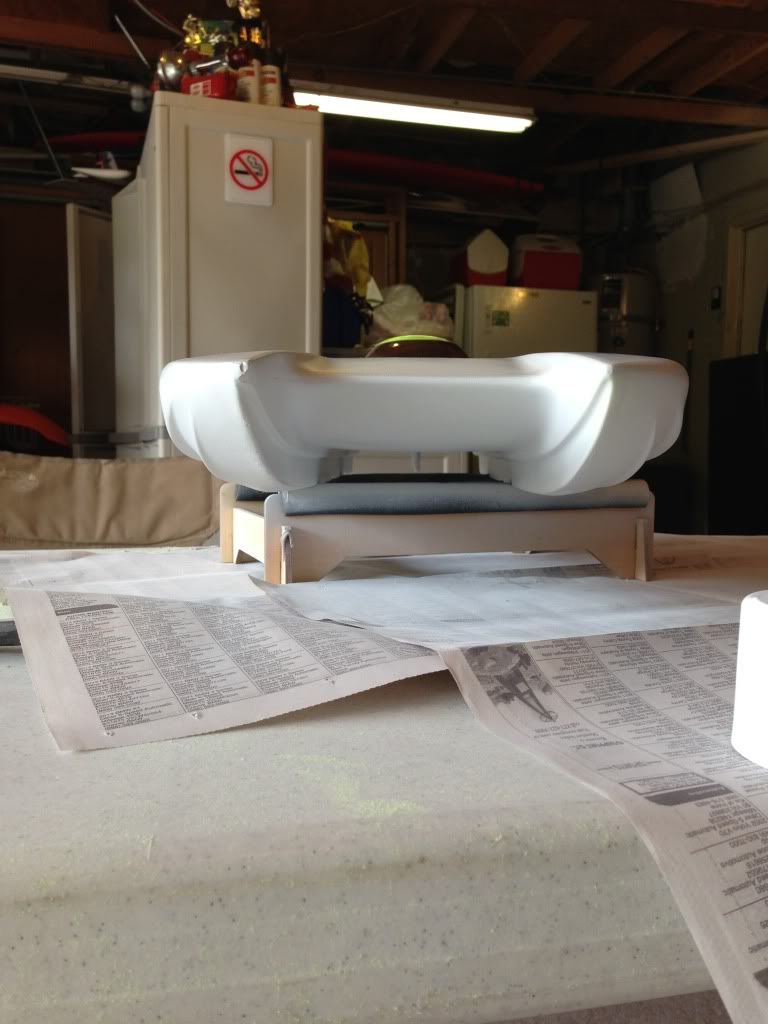

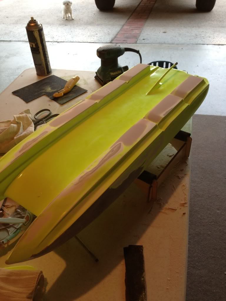

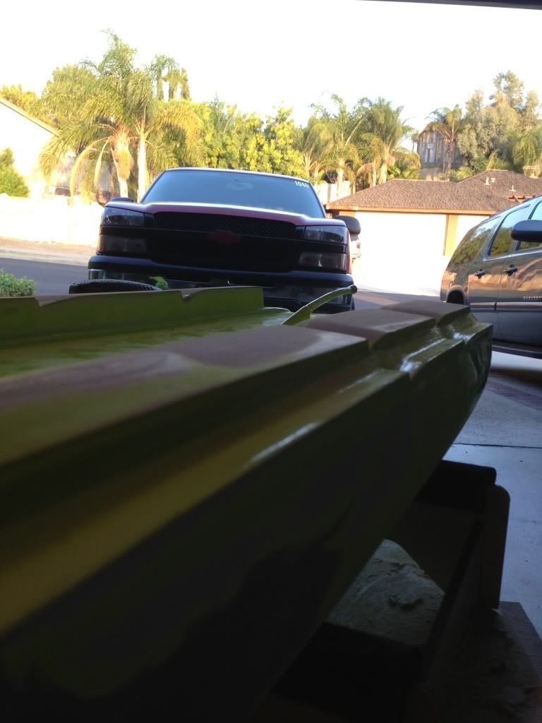

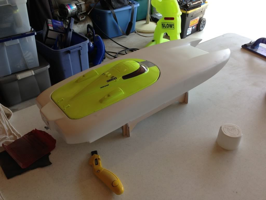

      Some sanding
      Sorta half assed it... This boat won't last long anyways. Haha

        Originally posted by Speedracer128
        Thanks Tlandauer,
        I'm going to sand the boat down this week and start working on the pads. After trueing the sponsons did the ride change much?
        Yes, day and night!
        Looks just like Gabe_k's although he did a much more thorough job than I did. I did not bother to true the front sponsons as I am by nature a lazy bum.

          @ Gabe_k,
          Looks fantastic, and let me tell you, you will now treasure the boat more than before. I completely understand your enjoyment with the repair!
          BTW, I LOVE the cute dog in the last pic.

            Nice work Gabe. I didn't realize how far off the sponsons come stock. Looks like I'm going to have some long nights this week

                Make sure you use a large flat block sander and not the orbital sander when you try to finish the ridepads. See Darin's raceprep thread on the MIss Geico for blueprinting guidance.

                  Thanks, I only used that sander to knock off material from the extra glass, the sponsons were done all by block

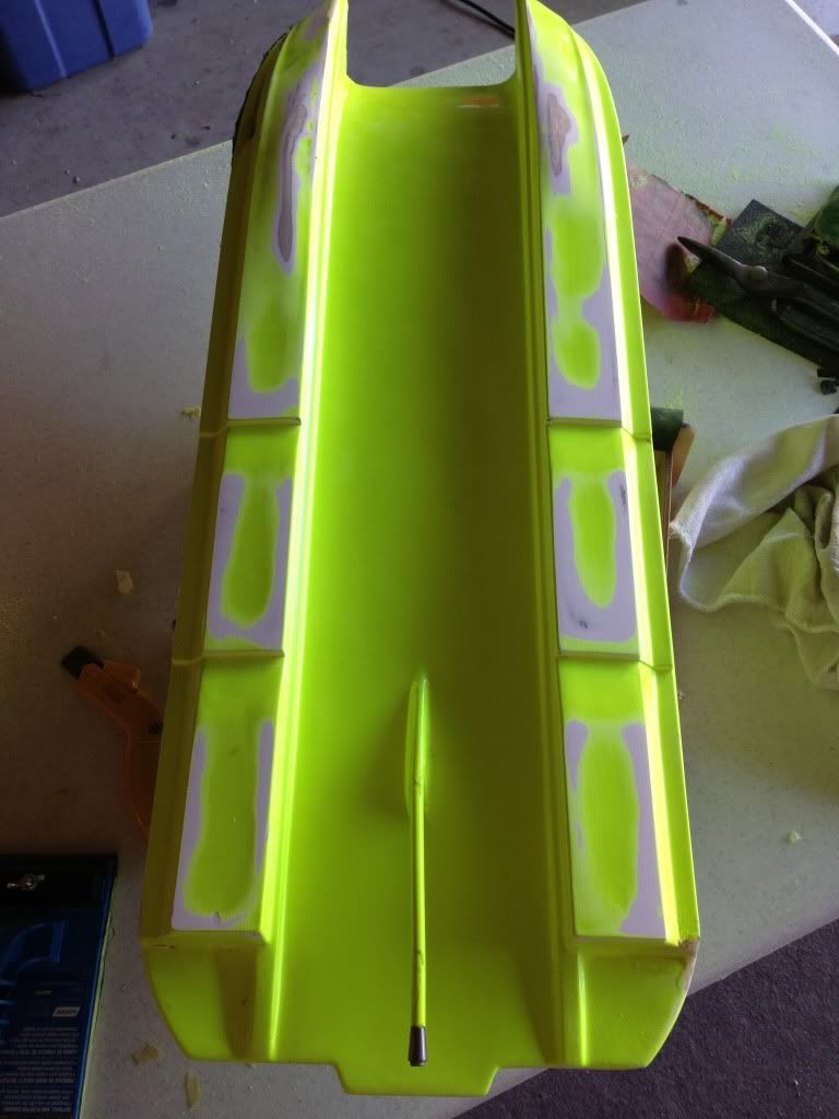

                    #39

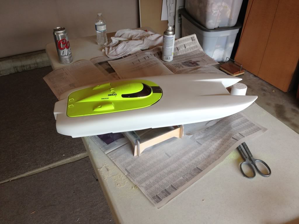

                    Some primer
                    It isn't the prettiest fix but I think she will work.

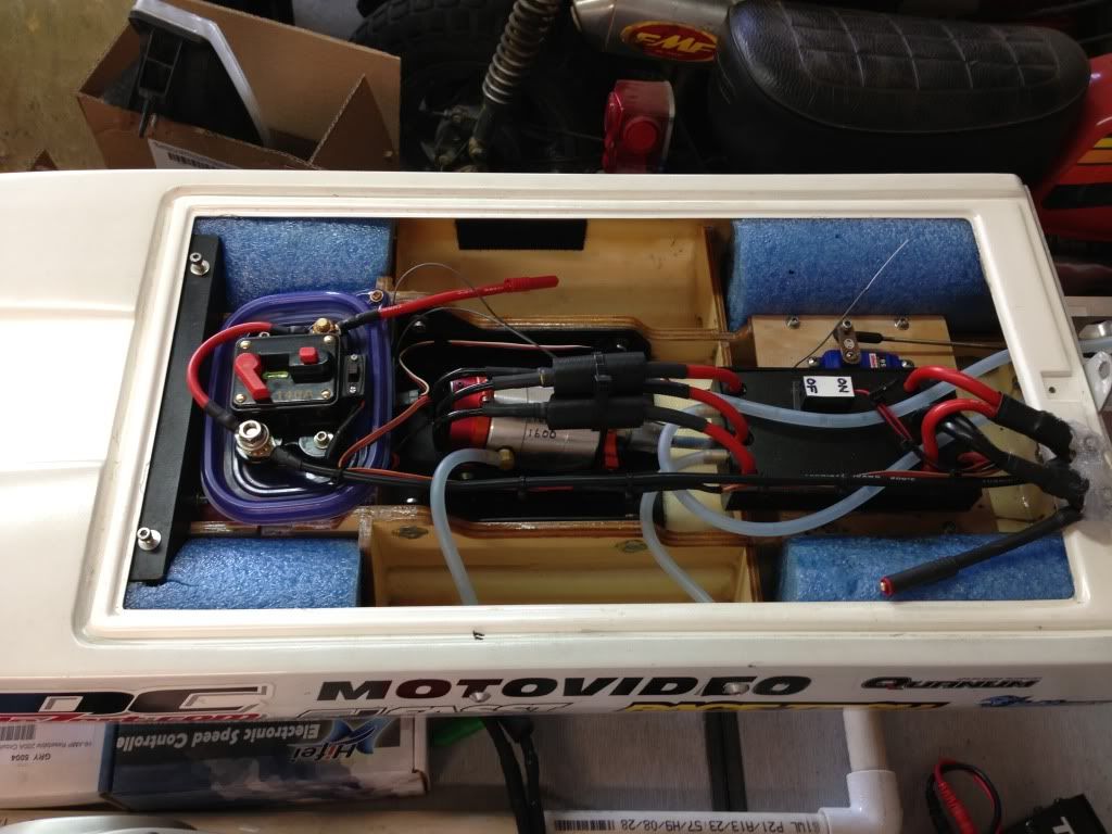

                            Here's a picture of my friends dads boat who actually motivated me to fix my boat up..
                            He runs a 8s and 10s set up... This is the fastest boat I've ever seen in person. He fried 3 castle 240 esc's and now has a 300a that he got off of here. Freakin nuts. He also just gave me a t180 and wouldn't even let me pay him for it..

                              That boat is sick! How fast is it running? Can't beat getting a 180 esc Fo free. I blew mine this sat. I think it's covered under warranty tho.
                              I ran with an old timer this weekend and he uses those floating doodles in his sponsons like that boat in the pick. It holds his batts inplace too. Seems to work well

                                Haha he swears by them! I should have done that from the beginning rather than put that foam in mine-__-
                                That hull was a gas boat so it's super sturdy, but very heavy.. But has no problem hitting 70.. I think 80 was his top speed or somewhere up there.
