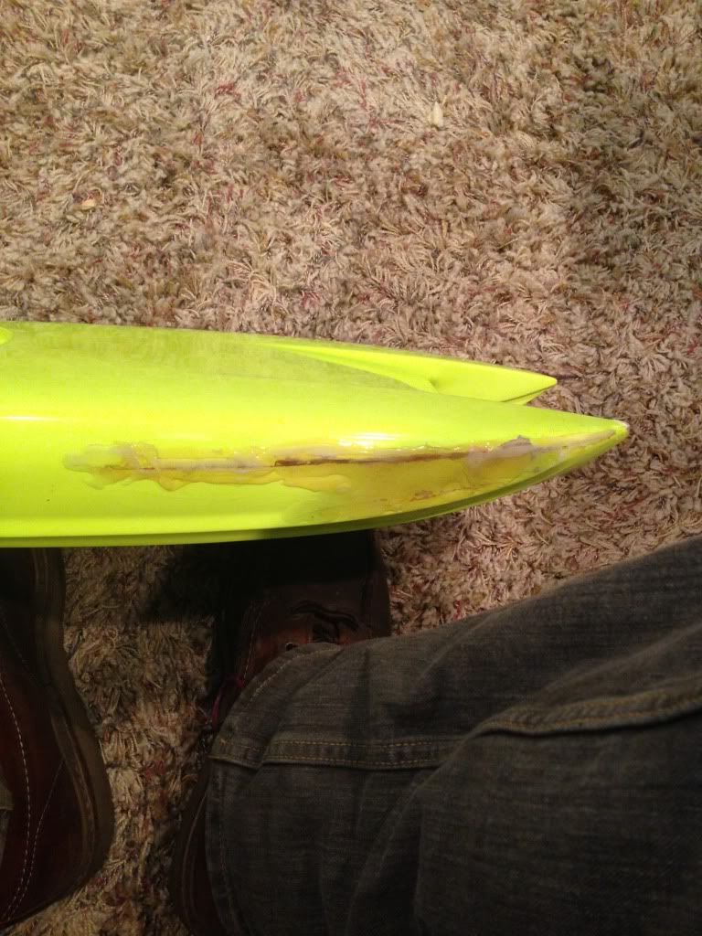

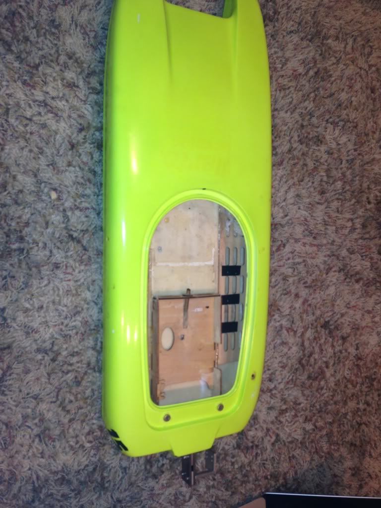

                        Got the old motor mount/wood set up out..
                        Will be putting a 4082 motor and mount in there.. Also epoxied the heck outta my split seem. Lol
                        I filled the entire hull with expandable foam so there is no what I can get in there to do glass work so this will have to do.
