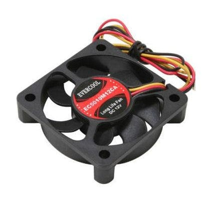

        You can mount a cpu 12 volt 50mm fan on it. This was a HV controller simular to this one with two heat sinks. Used some short metal screws to mount them. I series up the fan motors for 8S voltage. It worked great.
        Buy Evercool 50x50x10mm 3 Pin Tachometer Ball Bearing CPU Fan-EC5010M12CA from Coolerguys online store at best price. DC Fan Size: 50x50x10mm, Bearing Type: Tachometer Ball Bearing

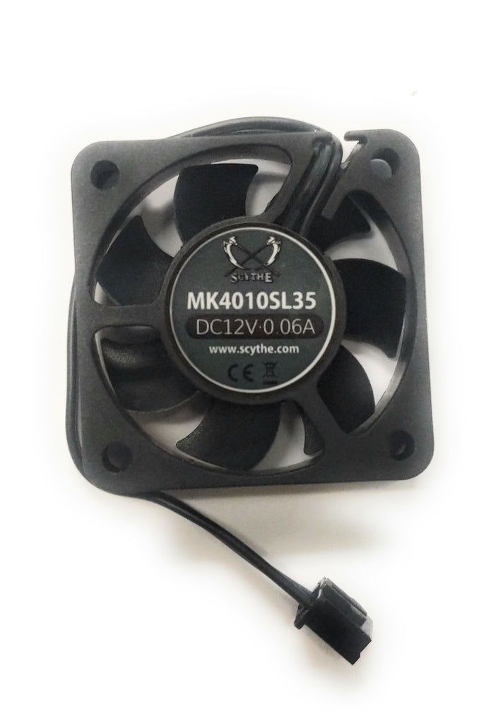

        This controller is 38mm wide. Here is a 12V 40 mm fan.
        Get your Scythe Mini Kaze 40mm fan from Coolerguys. We have the best selection of high quality computer fans and accessories for you to choose from.
                  http://www.coolerguys.com/840556069027.html
                  How did you attatch the fans?
                  • ReddyWatts
                    • 1711
                    #69
                    I used metal screws. Ground off the sharp tips and screwed them in between the cooling fins. I also cut some air exit slots. Connected the wires directly to the the controller source battery wires on 4S. I like that it keeps cooling the controller while you are getting it back to the bench, until you pull the battery leads.
                    Made a real easy and cheap cooling solution.

                        #71
                        A single fan. Use the red and black wires coming from the fan. Connect them directly to the controller input wires coming from the batteries. Works for 4S voltage.
                        I was running 8S and wired two fans in series and tied them directly to the battery leads on the controller.
