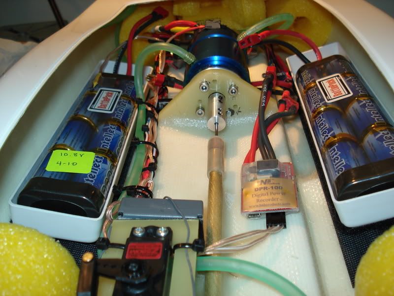

                    My setup for this eveing.
                    I agree. I really don't know how to apply the data yet. But it is great to have. I just finished up the internals in the Jolly for this eveing. The only thing I'm changing is temp probe #2 (yellow) is comming off the pack and going in the esc. Navibe is tucked up in the stern. I think I have flotation under control this time :). I will be without a rescue craft so I am keeping the boat shallow. Lucky for me the lake is waist deep for the first 50 to 75 feet out. I will have MrsSjfe to video for me also...But I think she more excited about the stop @ Ritas water ice along the way lol. Oh yeah she weighed in @ 7.8 pounds in the digital bathroom scale.

                      wow, everything is neatly crammed in that hull...
