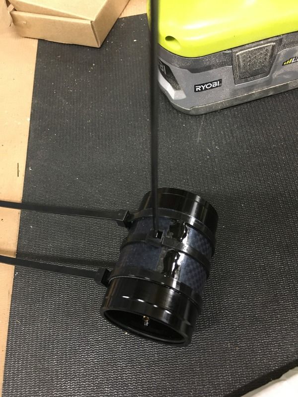

Moving right along. I soldered the 8mm bullets on the motor. I added a carbon wrap (sorry, as usual...it just looks so good!) to the cooling can. I'm going to show you guys my secret on how I do it. I've been told by a few people that they couldn't get there's to stay on and not peel up. My method has never failed me. So here it is.
First I use .010 thick carbon. Basically just one thin layer of cloth. Sometimes I'll lay it up on my own or I'll buy it. Depends on my mood. I've been making my own lately to say money but you can find super thing carbon on eBay. It's very flexible. I cut it to size. The way I get the length perfect is I wrap a piece of masking take around it and slice thru it where it overlaps. Then the length of the tape is perfect. Then cut your carbon to length. Scuff up the backside of the carbon. I then add a thin thin layer of 5 minute epoxy. When I say thin, I mean it. You don't want it oozing out. Have three long wire ties ready. Wrap the carbon around the cooler, join in the middle at the bottom side that you won't see when it's in the boat. Strap it tightly in there places. Then put two little strips of epoxy between the wire ties. Let dry. Cut straps off. Then add epoxy in the area the ties were in. Done.

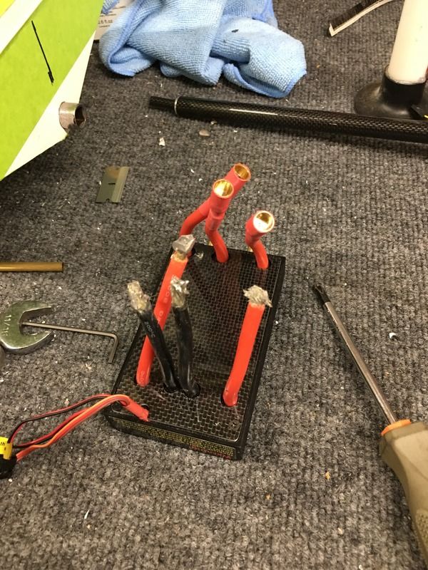

Got a little done today. I decided because my rudder didn't make it, why not finish (or attempt to) wiring the esc up and making a cap bank. I tried something different this time. I wanted a compact cap bank. I skipped the circuit board and glued the caps together then connected then with brass (I know copper would have been better but that's all I had) bar. Drilled holes through the bars and then side the cap legs through. Then routed the wires as nearly as you can with swordfishes screwed up wiring layout (ugh!!! I hate it!). Then epoxy sealed them.
