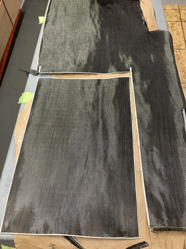

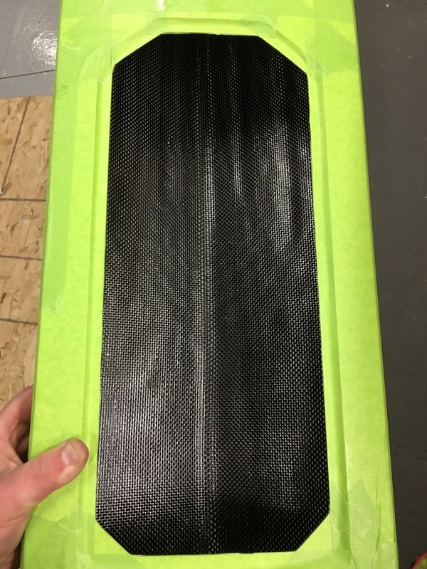

                          I guess it's that time. To do a really nice and neat job I do a mono a little different than a cat. I put the carbon fabric in dry. This hull is very stiff and really doesn't even need any carbon but I insist on doing it because grease and all that looks nasty on tan looking fiberglass. The carbon really dresses it up and it stays cleaner looking. The key to success here is making sure the epoxy soaks through. It's 65f in my shop right now (37f outside) and I have my epoxy a few feet from my heater so it will get a little thinner so it will soak in better. This may not be how some of you do it, but it works for me. I could put a coat of epoxy first then install the cloth but I'm wanting it lined up perfectly straight and I've never had it lift because I know how to get it soaked through. The only thing is to get it wet enough to soak it throughly I'll end up wasting some epoxy because I'll be soaking a bit back up. O well, sacrifice I'm willing to make for it to be perfect. I want this thing show quality.
                            #28
                            I wasn't planning on doing the inlay tonight, I was going to just cut the cloth out and do it another day, but I won't be in the shop for the next couple of days so I figured why not. It'll be cured by the time I get back to it.
                            I can't complain. It turned out pretty dang nice

                              Really great that you go into all that detail in your posts. I'm sure a lot of people appreciate that even if we don't mention it. There is always something new to learn! The inlay looks great. How do you keep that masking tape from separating when soaked? I tried this method but mine always came off and made a mess with carbon fraying, etc. Now I just use fabric glue, but the downside is that it takes time to cure. Oh, and keeping your epoxy by a heater is a neat trick. It's way easier to work with when it's warm.
                                The tape I use is high quality. I think it pactra brand, I get a big roll from my hobby shop. I think the main trick I've learned is to wear nitril gloves to keep from making snags and when I lay the tape I keep pressing it down firmly to make sure it's stuck firmly to the carbon. O and another important thing is to use sharp scissors, I use some .99 ones I get at harbor freight and I replace them often because they don't last long at all. I tried buying a $30 pair that's made for Kevlar but they didn't last much longer.....30 pairs of the cheapie will give me much more use for the same money. If your scissors aren't sharp and able to cut right through with ease then it'll pull the tape off and fray the fabric. When I put it in the hull and wet it out the tape stayed put, if it didn't you would really see it anyway because how far it goes up each side....it pretty much reaches the hatch lip
