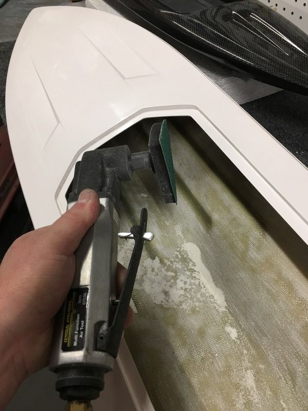

    So it's begun. My favorite part of the entire build......sanding. Not!
    Ok so I'm cheating a little. This works good for the flat areas
    I better tape it up before I scratch it or get epoxy on it!

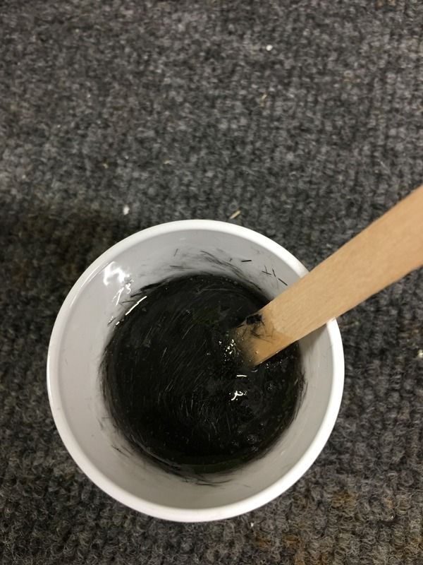

      So on my last one I built, the sexy green one, I was going 80 something and it flipped and split the hull a little at the seams. For some reason this hull seems to be made from a different but better epoxy and it has a fiberglass strip along the seam which the green one did not. Don't matter, I'm taking no chances, this one is getting reinforced at the seam. The first step is i mixed up some slow cure west epoxy and cut up some carbon cloth and put it in the epoxy.
      And mixed it in. So purty lookin
      No pic but I poured it down the seam and spread with a brush and then propped it up on its side. The other side tomorrow night.
