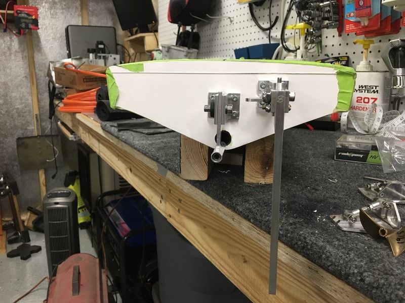

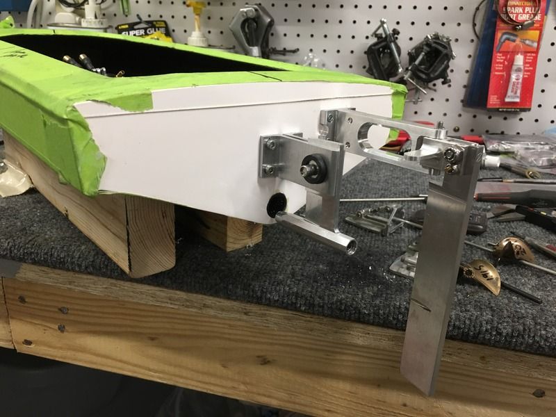

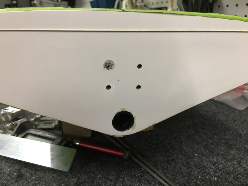

                                Yes it is. I did work on it again night before last. I got the servo mount plate cut out and I had to make a trim ring on the lathe. I messed up. When I drilled the pass through hole for the steering linkage evidently I wasn't paying attention. I drilled it too close to the rudder bracket and I would have had to bend the linkage for it to line up with the rudder horn. Ugh. I ended up filling the hole with white epoxy and moving it over. Now I feel better about it but you can see a little of the boogering. The boat will be painted so I can fix it then but for now I made a little angled trim ring to hide it and it actually looks nice and flows with everything so I may just keep it on there. I'll post some pics this evening. I'm getting ready to mount the servo and other electronics so it will be down hill from there.
