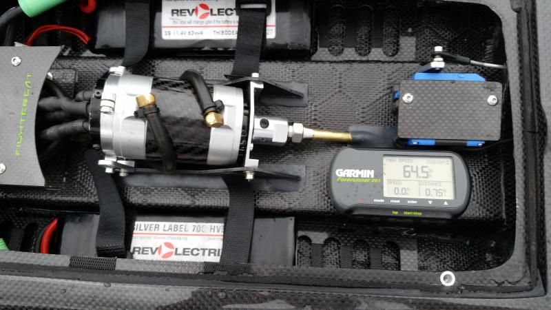

          I ran to the lake for a quick test run. Had some issues. It did go faster than last time but it's not quite right yet. For some reason my stuffing tube kept sliding forward and hitting the collet. Then the boat like the prop adjustment up high. The prop was almost hitting the bracket do I'll have to make some mods there. The boat was running super wet and you coukd hear it in the motor. Max Rpm recorded in the Data log was 31,706rpm. Max current was 263.0a. Was getting full throttle. The rainbow effect on the end of my flex shaft leads me to believe there was considerable drag and heat right there because of the tube sliding up. Just gotta work the bugs out, sometimes it's a process. Funny how I can build boats for people and have no problems and I build one for myself and it kicks my butt! Well I guess I'd rather it that way because if I sent a boat out having issues like this, I'd be embarrassed lol! Well anyway, here what she once the Batts were drained and I was getting the strut closer to were it wanted but the tube was dragging. (Ran on 6s)

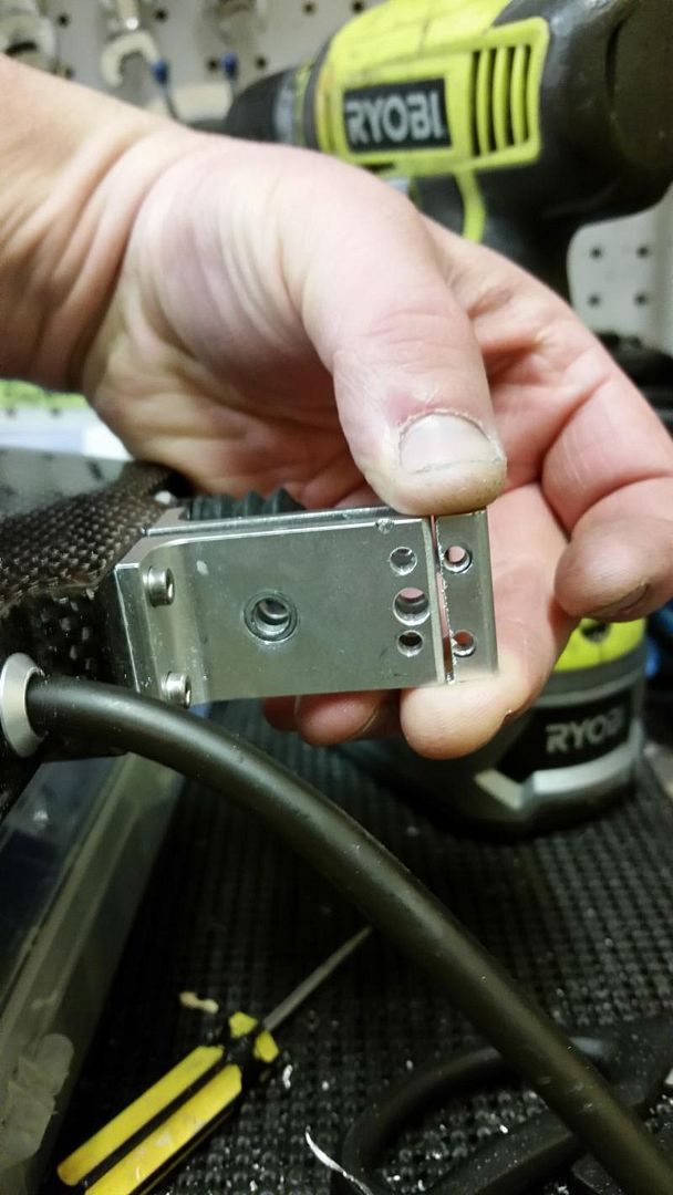

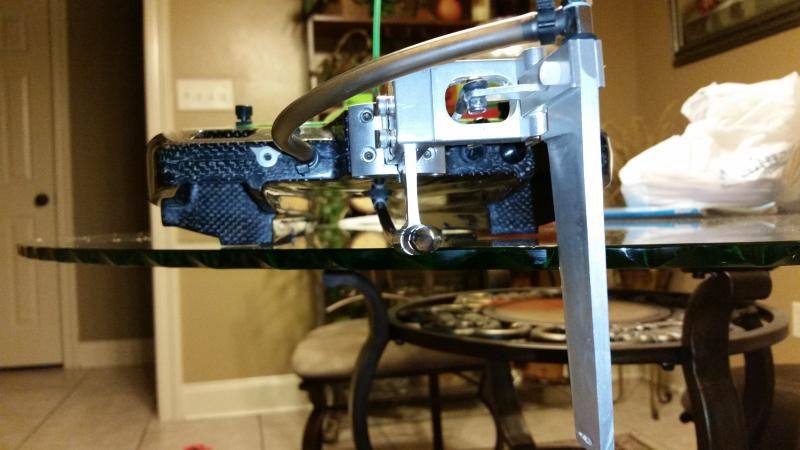

            I need to add something to this build. After running it and starting to get familiar with this hull, it seem as if the prop likes to be high up. Well it'll hit the offset bracket. So what I did was cut the main strut brackets mounted to the transom shorter. This little bit I cut off, was just enough so next time I go run, I can move it up where it wants to be.
            I just had to redial the holes and round the corners. I'll put it back together shortly and show pics of the clearance.

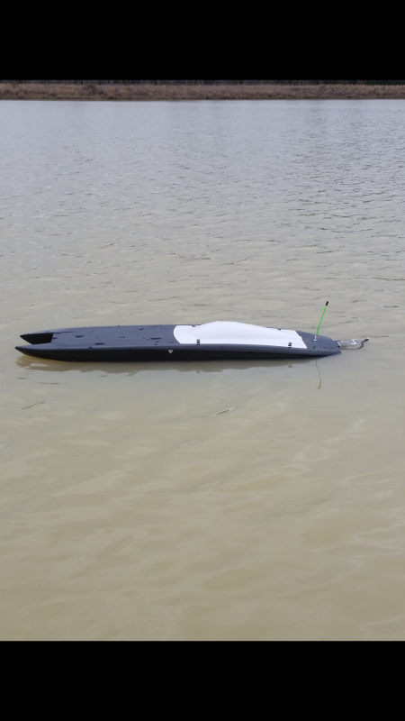

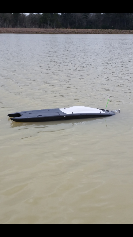

            And here's a couple nice pics on the water. I won't paint it and put decals on it till its tuned in.

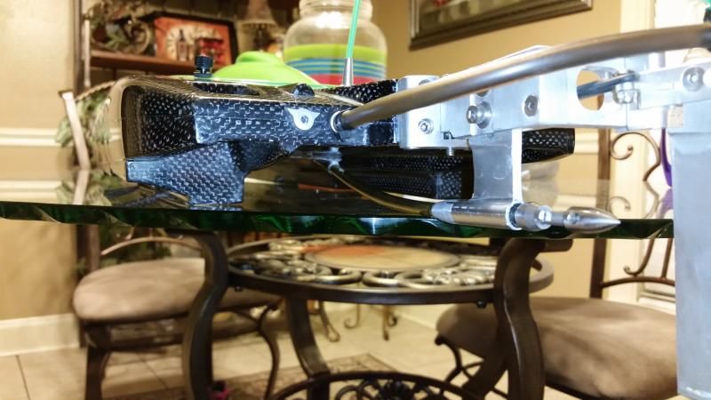

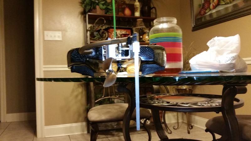

                      Ok here's the daytona sponsons....
                        #146
                        Here's the rivercat. ...
                        My theory is that the bottom pointed part on the daytona rides in the water deeper than the flat of the rivercat sponsons. So...when I set the prop depth, it throws me off thinking the prop on the daytona needs to be lower like the rivercat but in reality it needs to be higher because it rides deeper...I may be wrong but on looking at it, that's what it seems to me.

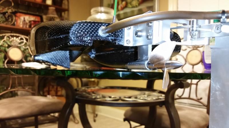

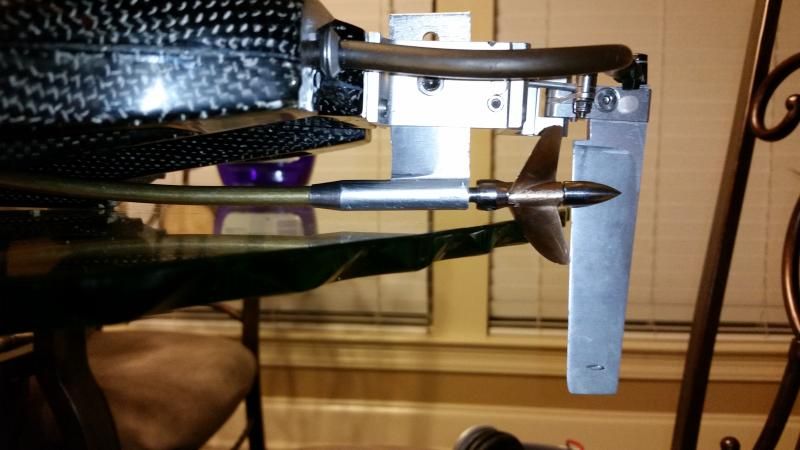

                          Here's how I have the prop set now... 3.45mm up. It would have hit the bracket before....
                          Notice where the prop would start biting at....well I think it would actually bite closer to the hub because the way it rides...

                            looks like that ruder might need to be shortened a little.. so the angled sponsens are to help with cornering ?
                              #149
                              I guess? I dunno but it does turn pretty decent. I may use a shorter rudder but for now I'll stay with it for stability. Btw, use red loctite on your bearings. Meant to text you earlier lol.
