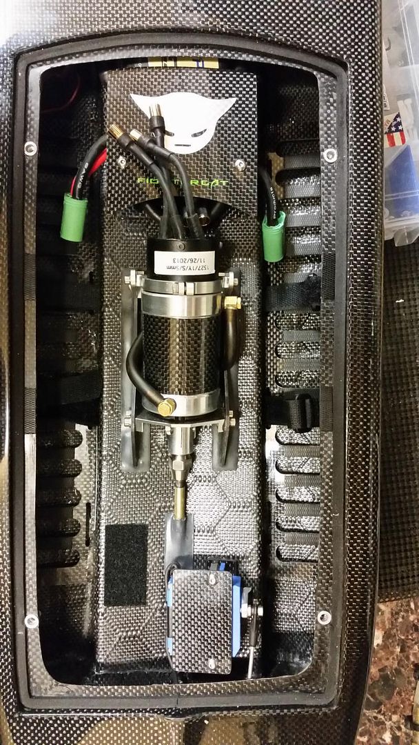

                          Trav, ya got a pic of the MG with the inlay?
                          I am feeling y'all on my idea, just thought I would throw it out there.
                            #178
                            • tjdabomb
                              • Jan 2014
                              • 219
                              #179
                              Excellent.
                              Maybe a noob question, but, why do most CF battery trays (not yours, obviously) only have perpendicular slots (port/starboard) and not longitudinal (stem/stern) slots so velcro straps can be affixed? makes no sense to me......
                                #180
                                Excellent.
                                No idea....I cut slots so I can strap it like a normal person. Lol
