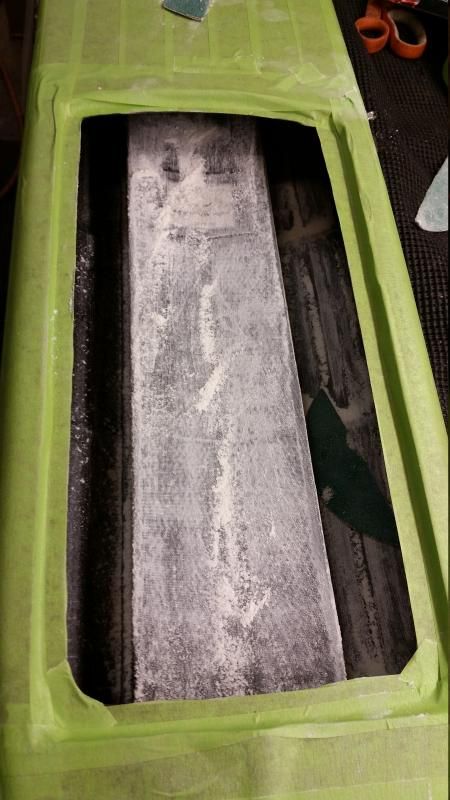

    This one I'm going to try a honey comb carbon inlay and do so different things to make it very tidy.

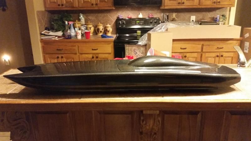

    This is one beautiful hull.....

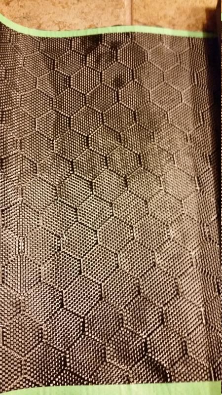

    Carbon I'll be using for the inlay. Nothing new but cool looking nonetheless. I first saw this in keiths builds. I thought it looked wonderful and thought I'd try it.

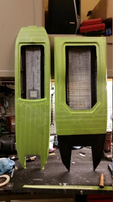

    As with the cheetah...my most favorite part...sanding! Ugh!

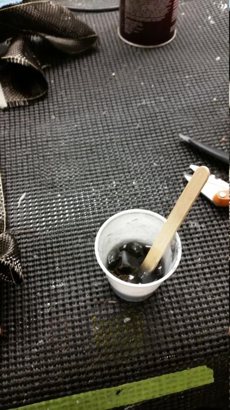

    Same as with the cheetah. ..mixing up some epoxy for reinforcement of the tips and tunnel. I chopped up some carbon cloth to mix in with the epoxy. I saw joel was doing this and it made sense as to why he was. I was doing just epoxy before, this seems like a better idea.
    Letting them babies cure till tomorrow. Then I will do the inlay on both of them. I can't wait!

        How much epoxy do you add to the tip's and what is your method for the tunnel?
          I put 30g in each tip. 45g in the tunnel. Pour in the same as the tips. I cut the carbon fiber a little longer so it would be thicker and more of a formal "clump", so the epoxy would stay put and not run into the tips.

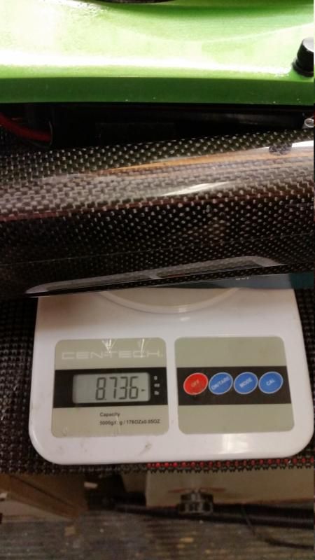

                Travis, you got me curious as to how much my Daytona does weigh fully loaded. Its only 7.5 lbs, a good bit lighter than I thought it was ! and this is with the tips filled with epoxy and about half the sponsons filled with 2 part expanding foam and a cf inlay. So I definately see yours coming in 3lbs or so heavier.
                  Did you mean you "dont" see mine coming in that much heavier?
                  Well this is my rivercat with batteries so being the daytona is a little bigger I think it'll weight right at 9 lbs. I think the weight makes a difference in how much it would torque roll.....

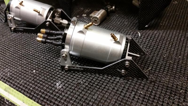

                      I thought about you yesterday when i started on it. I was hoping youd see the thread and follow it. This boat will be my "testbed" and because of the motor mount i'm using it will fit may different motors including lehner 22 series.

                        I do really like that mount and carbon cloth you using. Let me know how you like it and if it gives you enough adjustment and I'll go ahead and place one of order. Also, when you get a chance can you send me a link to a proper replacement ceramic bearing for the 1521. Figure before I have you start building and testing my equipment I might as well have it all in good order. Thanks!
                          you might as well get the mount....i assembled two of them last night and i really like them. I need you to look at the front of your motor and see if yours has a bigger bearing in the front than the back. if it does, they dont make that beaering in ceramic. I had to convert to the smaller bearing front cap on mine.

                            Alright I'll look at it tomorrow when I get back home. Is that mount from kintec?
                            KR X-Long 2 Axis Carbon Fiber Motor Mount
                              yep, thats it.
