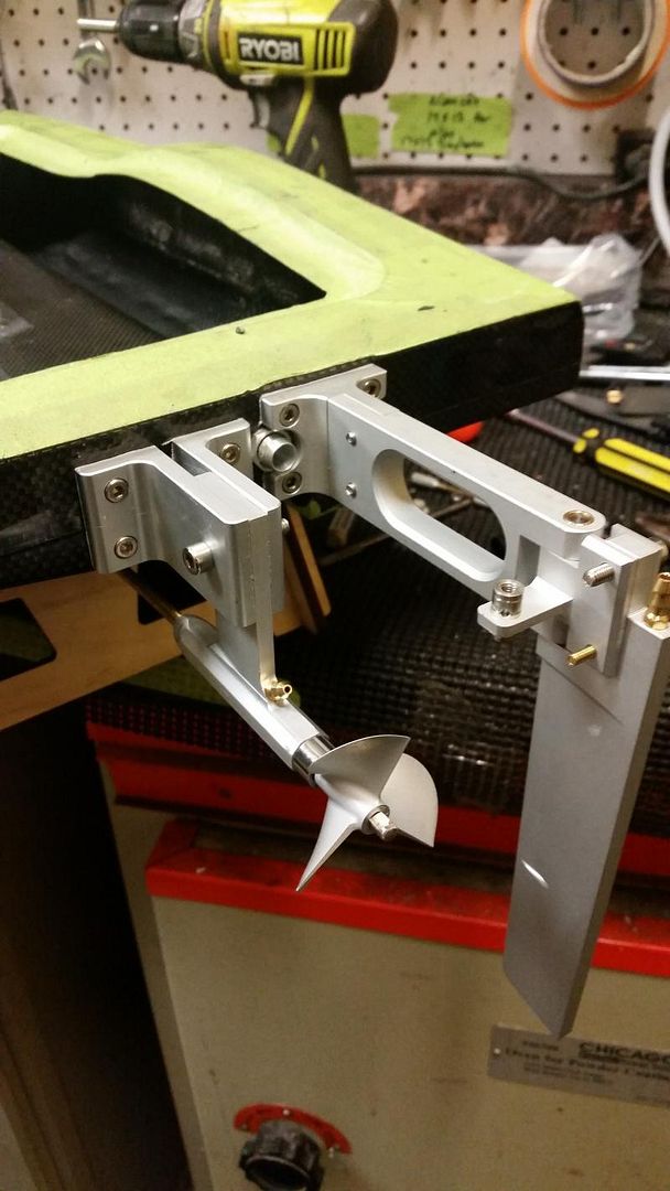

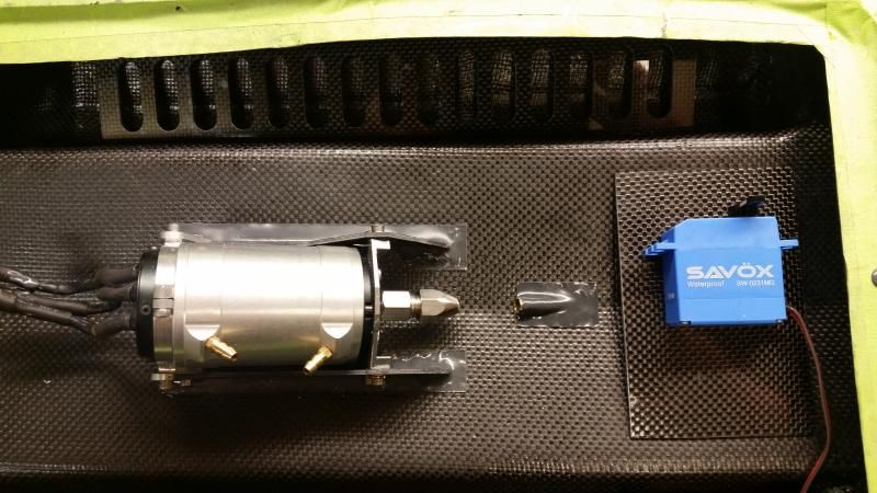

            I worked on the cheetah dome today. Actually got a good bit done. I mounted the strut and converted it yo 3/16 flex. Mounted rudder, billet steering boot transom fitting and made the servo/receiver/bec mount and a nifty cover to hide it all. So far I'm liking g it a lot. Here's some pics...
              • 8750
              #36
              Couple more
              How bout I cut that curve with my bang saw. I traced a skillet and then cut it very slowly. Required no tweaking. I was amazed myself.

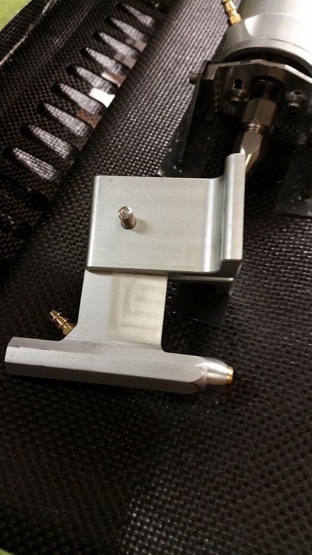

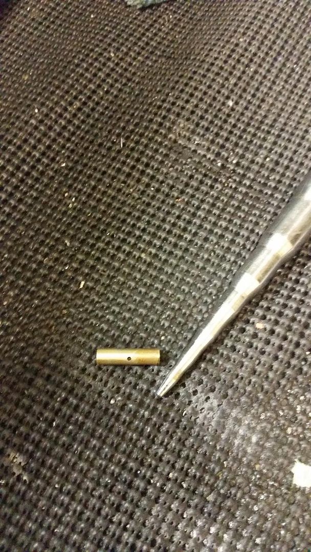

                  Now that I have a little time I'll post what I did to adapt the .250 flex strut.
                  I cut two 1" prices of brass. One fits snug in the bushing in the strut, the other fits snug into the first brass piece.
                  Then I drilled some holes in the bigger piece to solder them together. I used a little propane torch.
                  http://i218.photobucket.com/albums/cc243/ltzguy/20141206_151920.jpg[/IMG]"][/URL]
                  Soldered and sanded smooth on the belt sander
                    • 8750
                    #39
                    Then I took a swedging tool to it at the end to help hold it. Surprising how easy it was to swedge. It was blue loctite in place also.
                    Now I drilled a hole right in the middle. There a grease fitting and I still want to use it so the hole will let grease to the shaft. Hole shown in above pic.

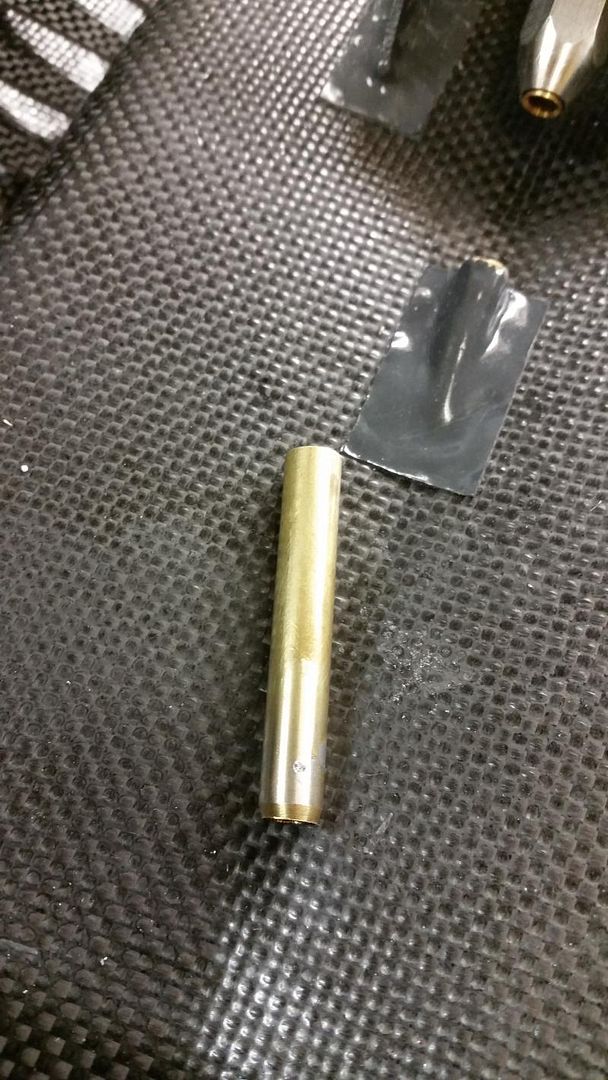

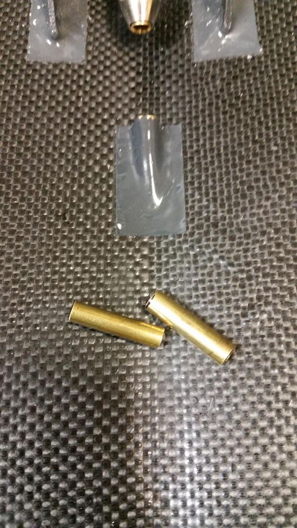

                    Then I made another bushing for the front. The stuffing tube is naturally too small just to go into the strut, so I used two sizes of tubing to adapt. Same method I soldered them together. I tapered the end of it. Then after confirming the length was correct, I blue loctite it in. The first attempt it was too long. The loctite grabbed it withing seconds and it would not come out. I had to heat it to get it out so don't worry, loctite will hold!
                    Then it's in the strut. I tapered the front of the strut because I felt like it

                                Looks great! Why the prop choice? I love how you curved the servo mount.
