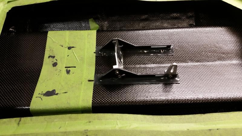

    Tacking the motor in place....

        Ray should work well with the watercooled lipos ....Travis I got too see one of those new motor mounts today, Sean got one. They are definately the way to go. Looking good as always brother... DJ

          These motor mounts are the shiznit

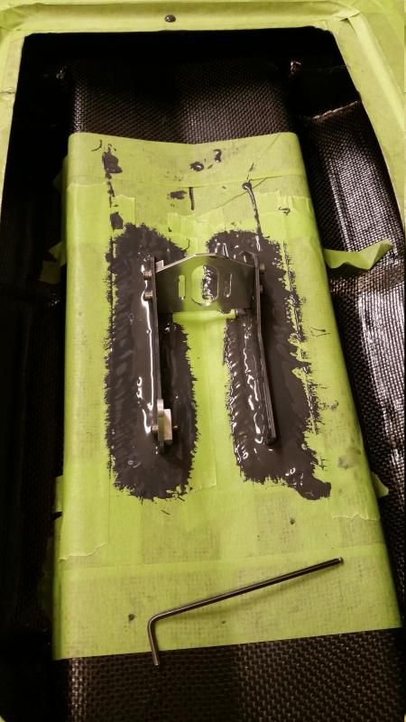

            I learned something when doing the daytona and applied it here. I heat up the jb weld a little till its kinda runny, then brush it outward to get a cleaner effect. When I peel the tape, it's going to look nice.

              The JB will look nice when done. Did you keep a blob off to the side so you can tell when it's setting up? I just want you to be able to get the tape off when it's cured or almost...
              Maybe you know what yer doing already...

                Yes sir, I time it. 4 hours and it's time to peel the tape. I use a gram scale to get my mix perfect every time

                  Turned out pretty nice.

                    Lookin' awsome Travis, as usual! You need to do a drag boat with DJ and I when you get done with all these other builds for other people. It'll be time to build one for yourself by then!!

                      Awesome Travis that motor mount looks clean!
