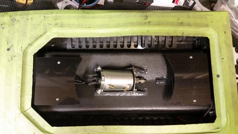

                      I pecked away at it the past couple days when I had some free time. I installed the battery trays, made the esc mount, installed it, put two part foam in the front and started laying out the cooling lines and wires. It's almost done.... Here's some pics.
                        • 8750
                        #56
                        Well I finished it up last night. All that's left if the hatch seal and I'm waiting on velcro straps to come in. Bench tested it, everything works flawless.

                          Beautiful job! Merry Christmas to you and the family as well. That's one nice clean looking build. Is this one for you or a customer, your doing the daytona for yourself but so much is coming out of the Kfx shed I loose track of things! Let's see it on the water!
