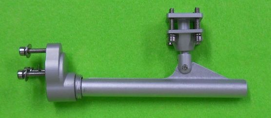

          how much do you think i could cut off joel. and should i thin it out also?

            Is that the 'scale rudder' Vin? You could probably take quite a bit from it if so. They are kinda bulky.

              yes it is a scale rudder. i believe it is from kintec the 6" one. the blade is 4 3/4" from the bottom of the bracket.

                  I don't have that rudder here, so I can't give you an exact measurement. Here is my SAW Fantasm with the rudder cut down. Even at this length the boat turns pretty well. For sport use however, I would leave it a just a tad longer then this.

                    I have the rudder here and one like Joels(full length though), I will try to get a pic to go off of for you later today, perhaps it will help.

                      Full length...

                          so if i leave it about 1" below the blade of the prop i should be good?
